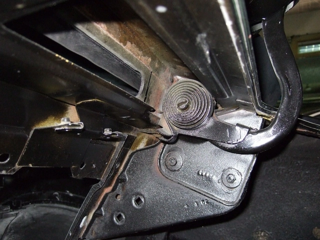

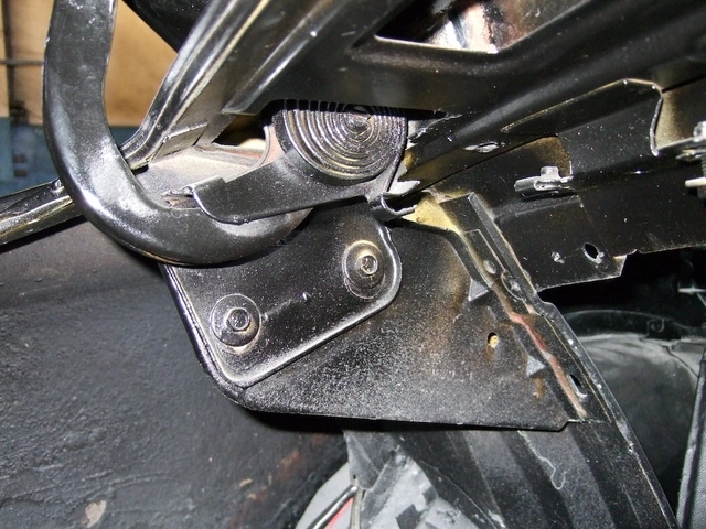

I believe my trunk lid springs have finally given up. The trunk lid won't stay up any more. Are there replacement springs available?? Or any other solution??
BTW, the car is a 69 Mach1.

Just bumping this up and adding some pics.
The hinges were not removed but we did take off the lid to replace the skin. Before body work, the lid would stay up. After body work it won't. Any idea how to fix it??
