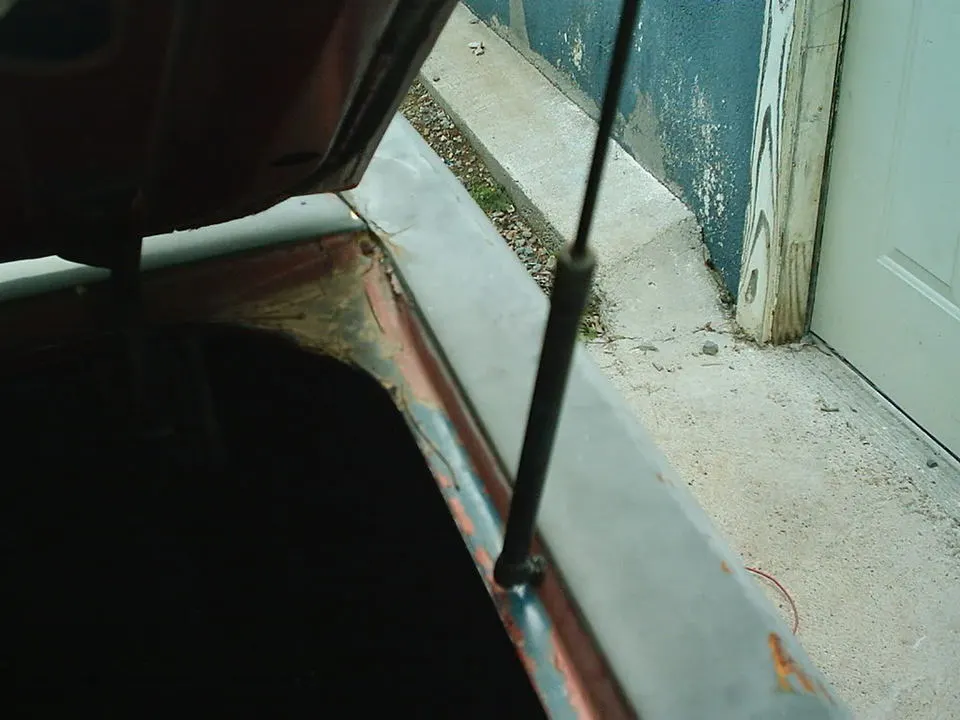

I've done one side, and it opens very nicely, but I'm not sure if I like the looks of it yet. Here is a pic.

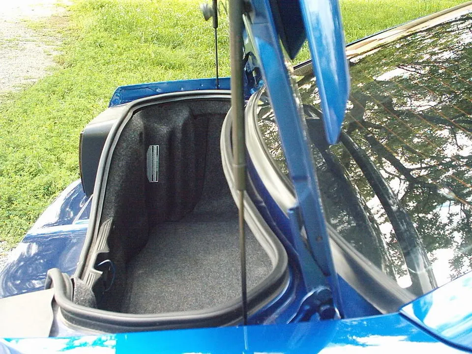

I think it might look better if the end attached to the body was further forward, toward the back glass like this pic of my 04. This would require a longer shock.
I should have re-aligned my trunklid before I started because it was slightly off center, and I'm not sure if everything will clear on one that is on right. I will try to re-align it and put the struts back on and let you know if everything clears ok.
I am open to suggestions any of you may have.

Don't you have it mounted upside down?
Not sure if I like the length, but this would be a good mod to go along with widening the factory inner tubs.
