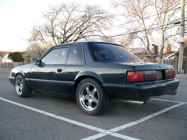

EDIT: My car has FRPP "B" springs. You can see the stance in my sig.
I have Steeda Sport springs with Energy Suspension poly isolators on mine (about 1 1/4 drop), the ride isnt too bad.
