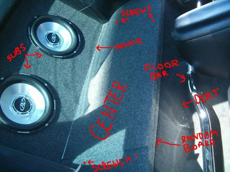

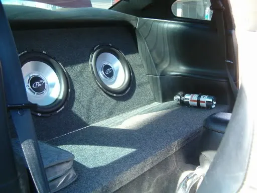

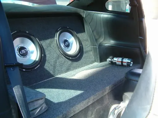

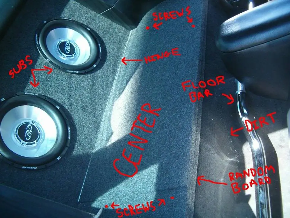

k, hold on, i'll post my rear seat delete, and hope you guys can understand how it goes...The Green GT, sorry I didn't reply to your PM, just read it now
Anyway, we simply took out the rear seats, and the metal framework around it...then, we used a cardboard stencil, drew out a perfect match, then cut to 3/4 inch mdf material. Here's how it looks:
a little more technical
I'm sure y'all will think i'm a dumbass, but wtf is MDF? I saved your very highly detailed seatdelete to my laptop, so i'll have it on hand, just in case i forget everything... thanks, I think i'll make a carboard cutout and see what i can come up with...
