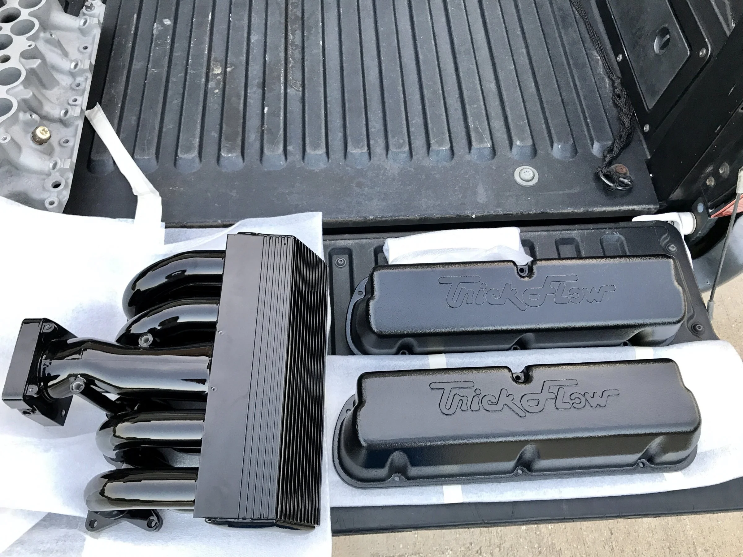

Ha this is true but I’ll probably run the V3 SI with tubular GT40, TFs 11r 170s, 1.6s, pro m 80 with 47lb inj. Was just wondering with out going to a custom cam would my F cam be good or is the TF stage 2 a better after market cam? Also I’m getting back into the game, car has been parked for 14 years. Now back in the day GT40 tubular was the big dog. Is this still good? Or should I swap out to say what I’ve seen a lot of ppl using on the fox’s now and get the Holley Systemax 2 or TF R series? Would be kind of a bummer since I just powder coated mine and it looks good.

That's a damn good looking GT40! The answer is that it will hold the combination back. You might consider having the lower ported. That will help some.... maybe on the order of 10-15 hp. However, another intake entirely would be better for making power.
Thanks man, seems as though a lot of ppl are still using these, and cobras or explorer intakes. But as I thought would be the answer sadly is that it would work but... might be restrictive vs getting one of those other intakes I mentioned. Idk maybe I’ll just try it and run it, see what kinda numbers I get and take it from there. Or sell it and just buy a TF R series. Decisions!!
