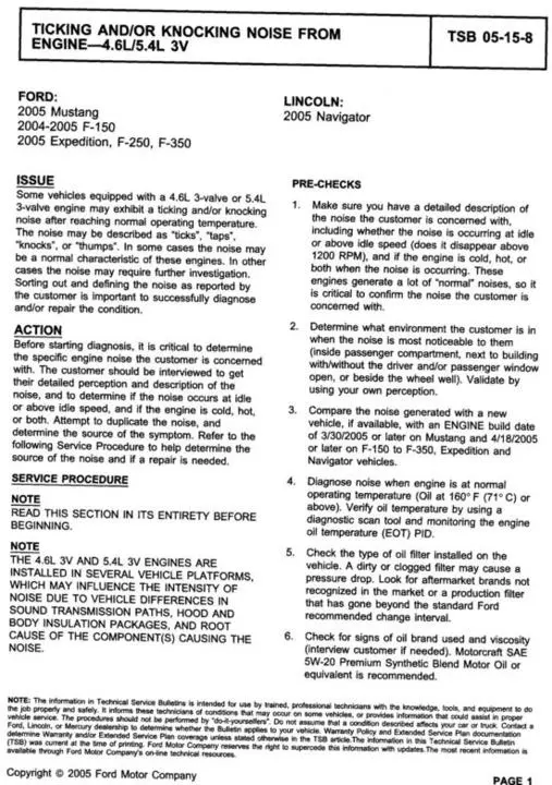

D dansilva929 Member Mar 20, 2006 59 0 6 Miami, Fl Jun 29, 2006 #1 Jun 29, 2006 #1 Does anyone have the text for this issue?
bigcat start with the upper hole, and if more traction is May 1, 2005 3,015 1 79 7200 feet Jun 29, 2006 #2 Jun 29, 2006 #2 Attachments 02fb4bff.webp 70.8 KB · Views: 175 d423b390.webp 53.8 KB · Views: 164
D dansilva929 Member Mar 20, 2006 59 0 6 Miami, Fl Jun 29, 2006 #3 Jun 29, 2006 #3 Awesome, thank you very much!
