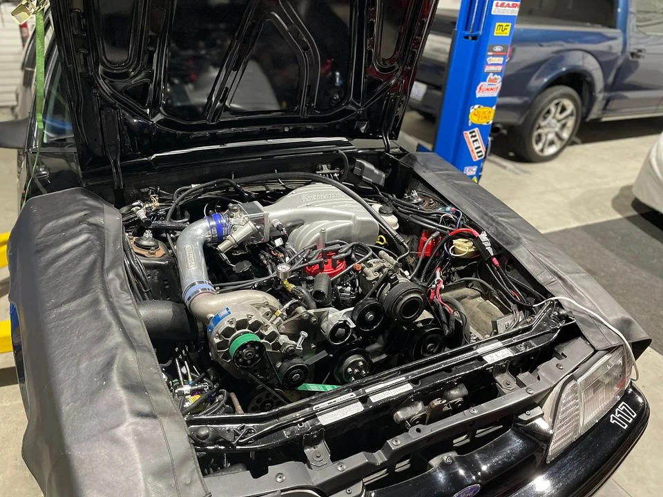

I recently picked up a used Vortech V2-Si supercharger kit and have been piecing it together for the car.
Waiting on a couple small parts (hopefully this week) and I will be able to fire it up.

Supercharger kit - Waiting on some small parts - silicone adapter, radiator cross over tube, etc.

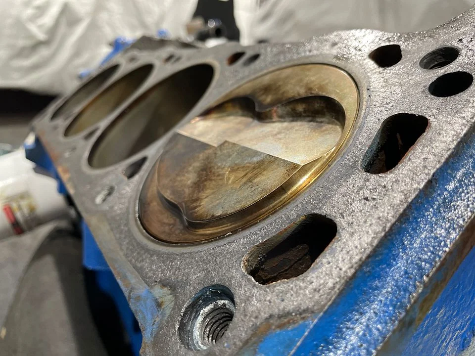

Pulled the 331 out. Having some issues breaking up over 5K rpm likely due to valvesprings weak.
Surprised to find this engine has dome pistons!
Gotta decide if to port the X302 heads and new springs or just replace some better flowing ones such as AFR.

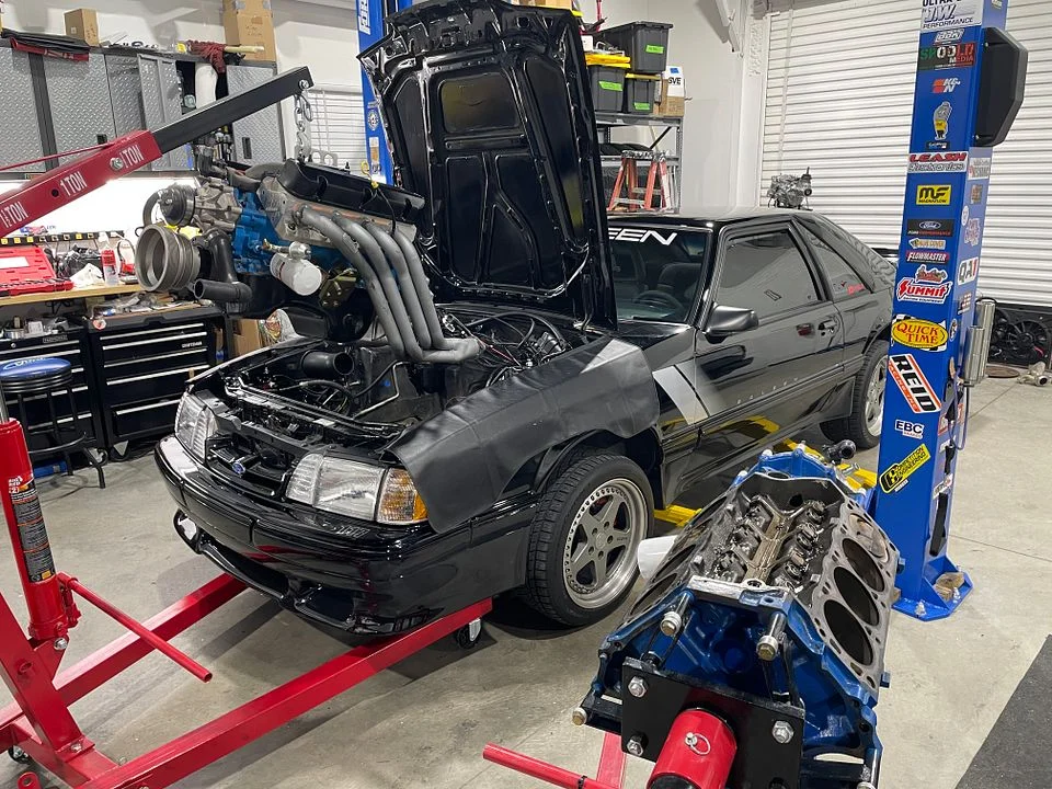

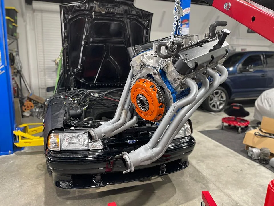

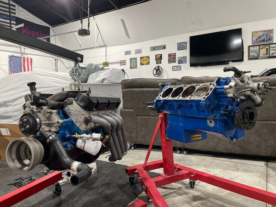

Got another engine and dropped it in. 347 with AFR Renegade 185 heads.
Had shoulder surgery so I cannot work on it for a few months now, which sucks.
Here's what I accomplished this week.
Monday - Pulled engine.
Tuesday - New engine installed. Finished at 1AM so didn't try to start it.
Wednesday - After surgery got it fired up and set static timing.
Fought an issue with this 347 engine that I finally figured out.
The balance was totally wrong. The engine came with a 50 oz flywheel and balancer already installed. These turned out to be wrong!
After many tries, I finally fixed it with Zero Balance on the balancer and flywheel.
I have the LMR balancer that you can remove the weight and a McLeod flywheel that allows me to remove/add weights.
