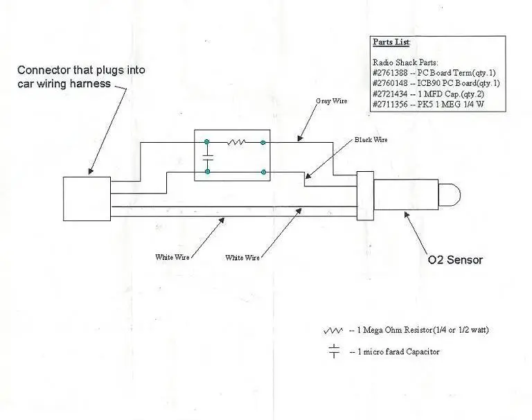

^^ I made one for the driver side of my cobra yesterday > cost mea trip to the junkyard to get the o2 plugs off of a junker and $5.00 at Radioshack> and a total of 10 min's to make them and plug them in .

A tuner isn't needed to get rid of the CEL, and neither is the trip to RadioShack. You can use spark plug non foulers and get rid of the CEL for under $5. I know several Mustang guys who have done this with success (don't know anyone who it didn't work for). I was skeptical at first, but decided to try it when my MIL's quit working. All I can say it it was super easy and worked like a charm. Here is a detailed write-up with pics:

The spark plug non foulers are the way to go. I had MIL's on my car and they quit working. Anything elecrical can fail. Wires can get shorts, cut, loose connection, etc. With the non foulers, it spaces the sensor out of the exhaust pipe so it gets a poor reading (thus being lower than the fronts and not triggering a check engine light). All I know is I'll never use anything else on my car. It's super cheap, simple, but yet functional.
