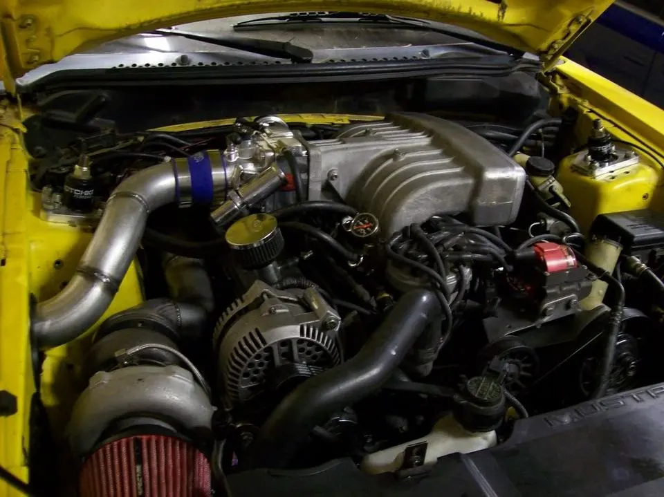

just for kicks heres a picture
I can think of anything else to check, if there is no valve train noise and your turbo is getting oil, then you have more then 0 psi or slightly above it. I believe a turbo only needs like 20-25 psi of oil pressure to supply itself, thats a indication if your getting oil to the turbo. how much is a oil pressure sending unit? its prob worth just swapping it out to see if it reads the same, take it back. i went with a manual oil pressure gauge. and ditched the stock gauge cluster because i had issues from before i turboed mine.
