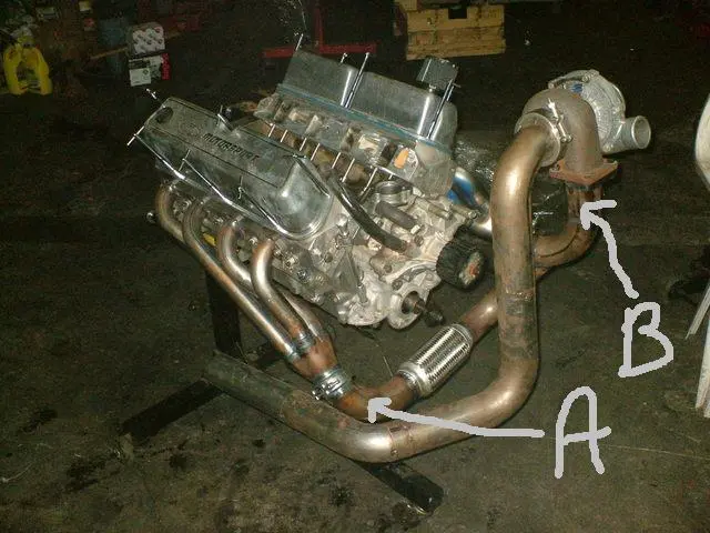

Have a question for you 10secgoal
I was going to PM you this question but there might be others that are wondering as well.
I attached a picture of your setup with crude labels just to make sure we're tlaking about the same parts.
What size pipe to you use for the crossover (A)?
What size is the merge pipe into the turbo (B)?
I will be using a T61 turbo, shooting for 400hp MAX, so what would you recommend? I dont' want to rev past 5,500, so I THINk smaller pipe would be better from me. But I don't want to restrict it too much. I'm thinking 2" for the crossover, and 2.5" for the merge. Any opinions on that?

Taylor... The crossover is 2.5, and the merge that goes into the turbo is the same. To be honest, I have used 2.25 for a crossover into a 2.5merge into the turbo. I plan to test that against this system I just made. But I have talked to bigger companies than me and they have told me that the 2.5 will spool a turbo faster. Again, I have no proof of this though.Just what the bigger guys tell me. I will know when I get my new kit running on my car. I have some safety upgrades to makes first though. That's a good size turb. would be alot of fun with a .84-.81 housing on it. Once I tighten my stall up, I think this kit could spool by 3200ish with 12-15 psi.
