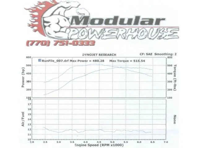

Not sure if anyone in this thread has a PH Turbo so I'll chime in. The basic kit with nothing else will eaisly make 500RWHP and over 500WTQ. I've got mine with a conservative tune and I'm making 480RWHP 16 timing and AFR is under 12. So if I wanted to crank up the timing a little I could easily make 500RWHP. The kit when I purchased it was around $5500 count on another $800-1500 to install it. The only other thing you might need is a MAF Extender as I was close to pegging my MAF with the 11# spring. Also you better consider upgrading your clutch at the same time. The stock clutch is only rated at 380wtq I'm making 515wtq and my stock clutch is starting to slip a little only after about 2-3k miles with the kit.
I've attached a pic of my dyno. Custom tune is required so plan on spending another $350 on the tune.
