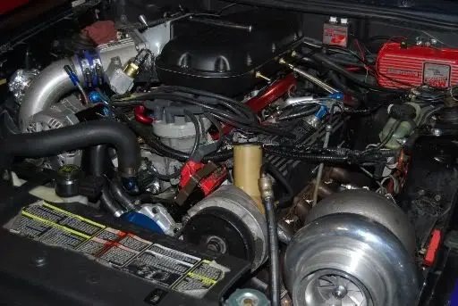

Hey everyone I haven't been posting much, but I thought I'd give an update on my car and talk about the possiblity of going NA.
This July I blew a HG. I tore it down swapped both HG's and put it all back together. I had at least one spot on one HG where it was blown. So I get it all back together, start it up and it runs fine, but it is still smoking and is going through coolant. So I parked it for the winter and took it off my mind. I'm starting to get the car bug though and am trying to figure out what to do. I at a minimum have to tear the intake off and/or HG's and try to figure out whats going on, but I'm pretty confused why it's still smoking.
Then I get to thinking about how reliable my car has been and I've been putting up with a lot of crap. Exhaust leaks, extra heat, driveability issues, not being able to replace plugs easily, extra weight, inconsistent track times and a lot of plug wire issues etc. I'm kind of tempted to sell the turbo stuff and build something like a 331 and try to put down as close to 400 as possible. It would be so much more reliable and I think I would just enjoy the car more. I do hate this idea at the same time though, because I do love the turbo and I've got my setup pretty nice. After getting the B&G headers and redoing my coldside and exhaust, the setup is pretty awesome.
I'd like to get some ideas down on a 331 or 347 stock block set-up. I don't think I need anything crazy for internals, but am willing to put the money where it would count the most. Anyone got any good ideas or input??
I'm starting to think that even with selling all my turbo stuff and related components I'd still have to fork out quite a bit of money to build an entire 331 or 347 and in the end have less power. I don't think that makes sense even though there are a lot of benefits.
I just want simplicity, especially in the engine bay and I'd like to get rid of all the weight. Decisions, decisions... I just don't think I can get rid of the turbo though.

IMHO, if you want to eliminate your head gasket issues….swap over to a decent set of aluminum heads.
A few years ago I hooked up a boost controller inline to my wastegates….backwards! Mind you, this was while I was running gt40p heads. After the gauge hit 18psi and damn near soiling my pants I developed an issue with lifting the heads under boost. This problem lingered through several sets of headgaskets/bolts/studs regardless of boost level. The block checked out fine, as did the heads. In the end, I sold the heads and picked up a set of used twisted wedge’s….and it was one of the best modifications I did. Since then, I have had no issues with head gaskets or lifting heads….and to add to that, I removed nearly well more than 50lbs off the front end. You see, the stock thin decked heads (gt40p’s included) are prone to lifting under boost…regardless of how well you seal them. It seems that like many of us, once you develop an issue with them….it won’t go away until you switch them out.
As for driveablity…..with the exception of the headgasket issues, that lies solely in your tune. There should be no reason why you couldn’t daily drive your turbo’d setup. Sure, underhood temps get a little hotter….but thank god we sit there. As for your spark plugs….honestly, unless you are changing them out every 3k miles (which there is no reason to do), it’s not that big of a deal. You should be able to keep them in there for 10k-15k miles or more (they are rated for far more than that). Another option would be to pick up some high dollar iridium plugs (as came with most Incon kits) and not worry about changing them for years. Of course, you could always swap out to an aftermarket k-member which would allow quick and easy access for plug changes below.
You want driveability? Get a decent set of heads and hardware & some iridium plugs with your tax return (as well as a good tune!) and call it a day.

You blowing a headgasket was a sign that something was awry with your tune. The fact that you threw cometic gaskets on it and cracked 3 rings simply proves it.
There are plenty of people running around on turbo'd 302 stock shortblock (and long) based setups as their daily drivers. If you get a good tune and keep the rpm low.....they can last a long time. To top it off, because you can keep the rev's down and maintain a nice broad torque curve....drive-ability can be excellent, as can fuel economy.

I have been running AFR 185's for a very long time on my old 302 and also my current 331, and have yet had a head gasket blow out even at 23 PSI, but I have broken many other parts of the car :D Side note: I will be upgrading to a larger 200+cc aluminum head with my tax return:eek:
All this aside It could be a few things causing this, just too name a few:
1. your tune sucks
2. your heads are warped
3. your block is not "0 decked" (beleive this is what it's called)
4. your driver mod sucks and you cannot lay off raising the PSI level.
**I have seen and met many a fools who get too greedy on the PSI level (ah what's ONE more PSI gonna do to it?) attitude without changing the tune and when it goes bad claim innocence (sp) :rolleyes:

I think some of you are still confused (no offense) but none of this has anything to do with why he blew a HG. His HG blew cause some D-bag was driving it at WOT when it ran out of gas. The tune was fine. The car has ran great for a couple years now aside from the bad idle.
Now if you are referring to why its still smoking after the rebuild then #2 or 3 may be of consideration.
