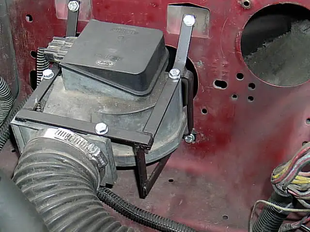

Yeah you can't buy one. You can make your own, or modify a cold air kit from another car. I kinda made mine, put two intake tubes together end to end and made a bracket to hold the VAM. Works pretty good.
