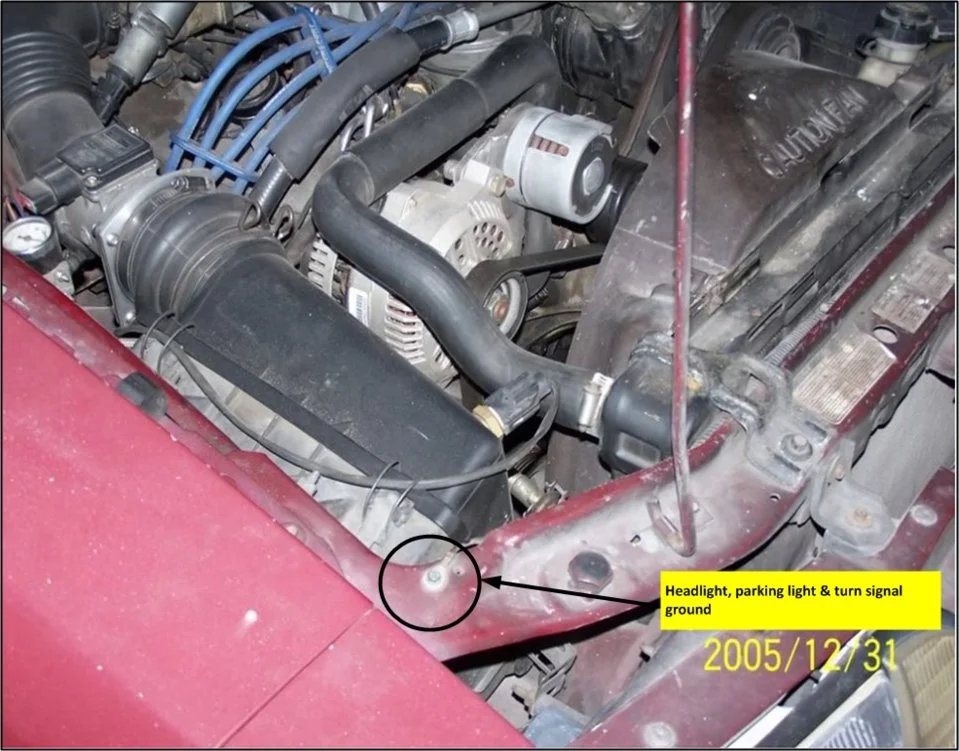

@Benz510
Check out the passenger side light ground - it is for the parking lights, headlights and turn signals.

jrichker said:
@Benz510
Gotcha. Should there be one on the other side as well?
Yes, same place on the other side.
