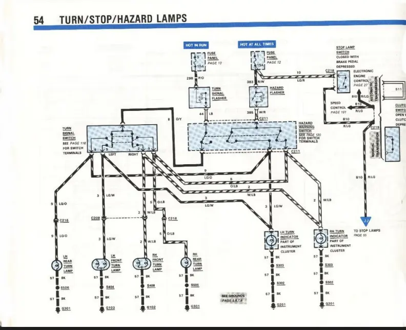

Just had a quick question so been fighting sense had the car lol. My hazard switch lights work you can see they work all the lights flash on the outside. The turn signals still didn't work So i bought a whole new hazard switch now hazards still work and now the right turn signal works but still not left just curious anyone could tell me why or have a idea
Here's the 1988 Wiring diagram for the turn signals and hazards. Serparate fuses, separate flasher modules. Both into the hazard switch first
