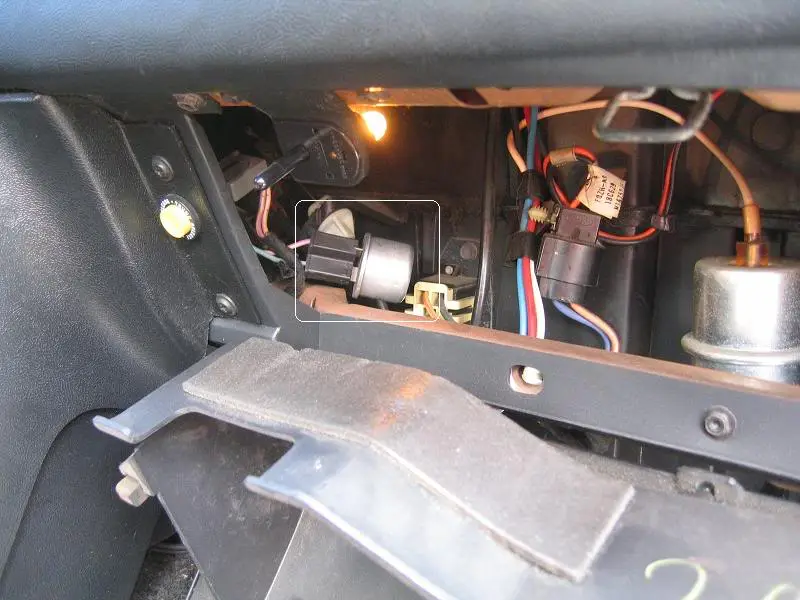

Have fun finding the flasher. The flasher on the fuse panel is for the hazard lights. The real turn signal flasher has several different possible locations depending on the year model and the tilt of the moon. Some are on the back side of the fuse panel, some are by the radio and some are over near the glove box. It is an easter egg hunt...
As mentioned above, the flasher for the turn signals is burried somewhere in the dash. I found it easiest to find by opening the glove box, squeezing both sides of it so it opens all the way (just hangs on it's hinge) and the flasher was right there. That's where it usually is, behind a/c, heater controls. I actually changed it once while driving down the highway when my blinkes just stopped working I pulled the hazard flasher out and made my turn signals work, they were more important at the time.:D Here is a picture.
