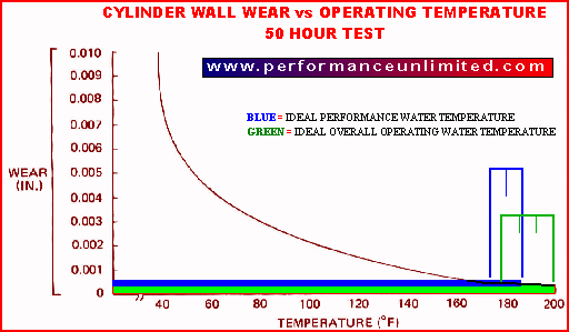

I have read several places that the 302s run most efficiently around 200 degrees. Engine wear supposedly increases a good deal when you run colder. I wish I could remember now at least one source to back this up - if I do, I'll be sure to post it - maybe someone else can confirm or deny.
Wes
Yes i Also remember that, if i recall correctly it was more for those who use 160F Thermostats
If I recall correctly the green zone of wear & effic. was between 190 - 210 more or less than that would cause a wear + 30-40%
Bingo!
Here's a decent graph...
(but I their "Ideal" temps up about 10F higher that what is shown here... just my preference...)
Can anyone else look at their ECT vs stock temperate gauge and see what they are reading at 180 and 190 deg.
We always talk about how inaccurate the stock gauges are but I wonder if the differences everyone sees are mainly due to differences in cooling setups/fluid ratios.
Or the gauges could truly be inaccurate. :)
Wes
