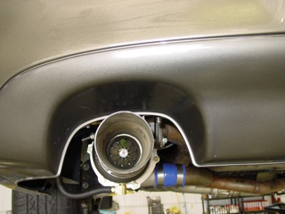

Anyway, in reading up on the STS rear mounted turbo systems, it seems as though they work. There is a lot of debat over them but I've yet to find any really good points against the system other than the heat loss. I was thinking you can size the units to accomidate for that effect. If you wrap your exhuast really well to the turbo you might get some more heat to them but bot much. Still, wosrt case secenario for you, you spend a couple more weekends and a little more money and mount all the stuff you bought in the engine bay anyway.
Also, don't forget you might need to do something with the H-pipe if you're doing 2 turbos. You might have to block the crossover.

91LX_5L said:
does anyone do rear mounted on a stang? i like the idea, whats the downfalls of it?
well turbos already naturally have some lag to them before they hit full boost... turbos work off heat....so the fruther u place the turbo away from the engine, the cooler the exhaust temp, and the less effiecient the turbo is....in theory u want it as close to the primaries as possible....atleast from my understanding, this will minize lag and enable quicker spool up time.
i mean think of it taking 5 secs to hit full boost at wot....you may have 400hp but the 300whp car just blew by you...heh all about usuable horsepower, but keep in mind there are still other factors which determine lag, mainly particular turbo size choice
also imagine going over a speed bump and smash :)
turbo's work off heat?
i've been totally mistaken about the innerworkings of the turbo before as the hotside powers the coldside blade whereas I thought some of the exhaust was recycled back in
but, how do turbos work off heat? i was under the impression that the exhaust pressure spun the hotside therefore powering the coldside and creating pressure which was vented back to the intake. and by that, having a rear mounted turbo would totally up the lag time because of the length of piping needed
