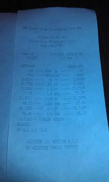

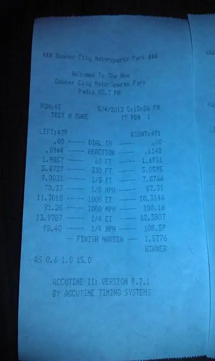

Guess I forgot to add to the first post the reason why this was my fastest pass with this car. The front calipers were sticking, and I never knew it. They weren't terrible, but the car wouldn't roll. Finally changed them and this was the result.
