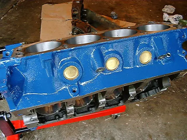

i also used POR 15 to paint my block. used the "engine paint kit." still looks the same after about 1000 miles.
