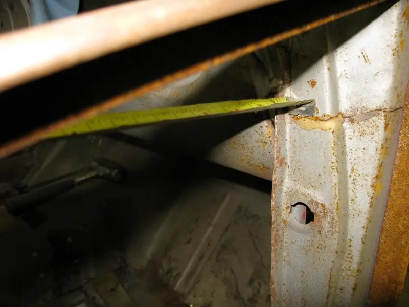

Also, does anyone have a measurement for the door opening? I don't think it moved at all, but I'd like to double check. Right now the car is supported with jack stands at the four corners, and then a couple of screw jacks under the subframe connectors. I used a laser level and some shims to get the corner jacks level, so I know the car isn't twisted, but I just want to make sure it isn't bowed in the middle.

I can't tell by the pictures but did you leave the middle cover plate on outer rocker? New rockers come with themif you did. If I don;t get home too late tonight I will meaure my doors but I'm sure your fine - especially if you left the middle plate in and with door braces you have.

Measured a couple points but not sure it will do you much good. If you have specific areas you'd like me to measure let me know.
Points I measured:
1. 44 5/8 distance from hole for door plunger for interior light to middle hole of door latch in pillar.
2. 45 1/2 disance from door plundger hole to bottom edge of rear window opening in pillar.
I replaced my rockers too. So if off I would not be too concerned if little different. I'm pretty sure no sags on mine - doors lined up pretty good.
I just noticed you have subframe connectors too. I'd be willing to bet your okay.

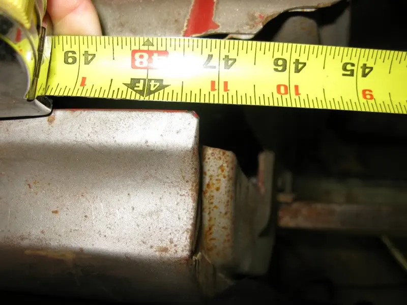

my measurements ended up being about 1/4" more than yours, but it's even from side to side (with the original driver side rocker in place). If you don't mind, can I get a measurement from the top front corner of the quarter panel to the body panel intersection just above the plunger hole?

Sure - anyway you can take a picute and point out exactly the measurement spots.

reads 47-1/4"

That helps will do this evening. Also when I measured to plunger hole on original measurements I measured from dead center on the hole - the hole is flanged out - could theat be where the 1/4" difference is?

Yeah I was measuring from the middle of the hole. I think part of the problem is that where the rear window slot was is a little bit bent in on mine, and I have a hard time measuring to where the middle striker hole is because of my door brace being in the way.
