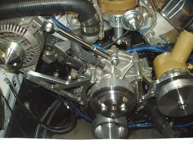

March sells one:

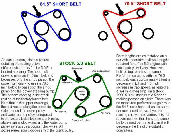

Well....I inadvertently got to drive my car withOUT Power Steering last night. :)
I had just swapped in Underdrive Pulleys (crank and waterpump), and my belt was too loose (Tensioner at Full travel). Needless to say, it was NOT near as bad as I was thinking it was gonna be to turn (even at low speeds).
I'm going out now to buy a Short Belt (70.5") to by-pass the Smog Pump along with by-passing the Power Steering pump. :nice:
See pic below....

I just got back from the parts store with a 705KD belt (70.5"). I'll go install it now and report back later. :spot:
Well, the belt ended up being a 68.5"s after w/Underdrive pulleys, Smog Pump Delete and P/S Delete.
Part #685K6 Dayco
The results are no-the-less astonding! :nice:
BIG TIME SOTP improvement! :spot: Feels like I've unleashed another 20HP (at least!!). :D
Yea, the P/S take work, but the "Feel" is just the way a "Muscle Car" should feel IMHO!! The steering is now VERY predicable and firm.
I think I'll now proclaim that P/S is for Sissies!! :rlaugh: :spot: :nice:
