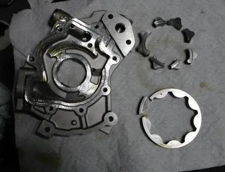

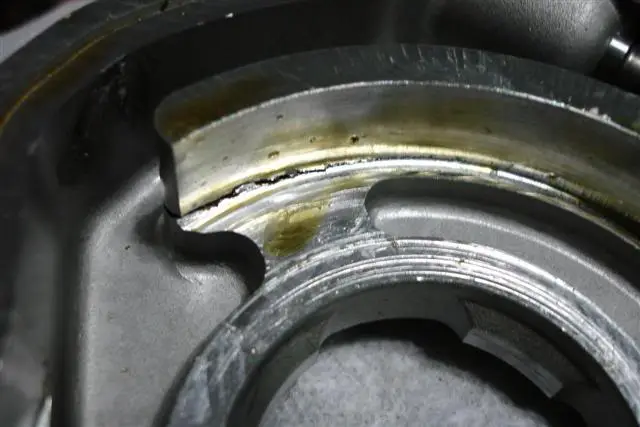

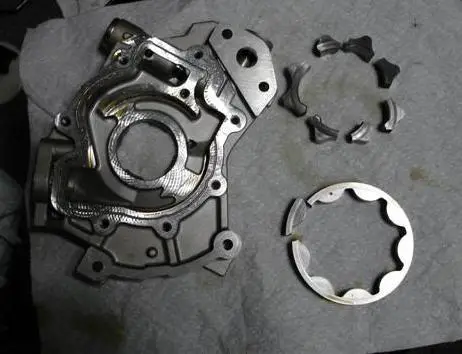

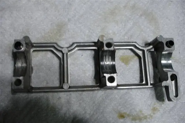

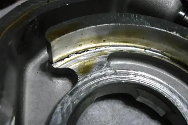

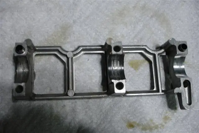

my oil pump blew up in my car which caused no oil pressure to the rest of the motor.
the heads ran dry and one of the driver side cams seized on the cap. if the caps on the heads are ruined so are the heads as a result of the way they are manufactured. they are made as one on the assembly line and you cant mix and match caps from different heads, even from passenger side to driver side on the same motor.
the chain snapped and was spinning around but didnt cause any damage like that to my valve cover but there were metal shavings all over the place. when the oil was drained it looked like glitter.
i dont want to scare you but be prepared for the worst. it may have just been the cam bolt that backed itself out or something more serious in the bottom failed causing a chain reaction of events (like in my case). if it is the worst case scenario, if your engine is stock, you may want to look into buying a replacement longblock.
