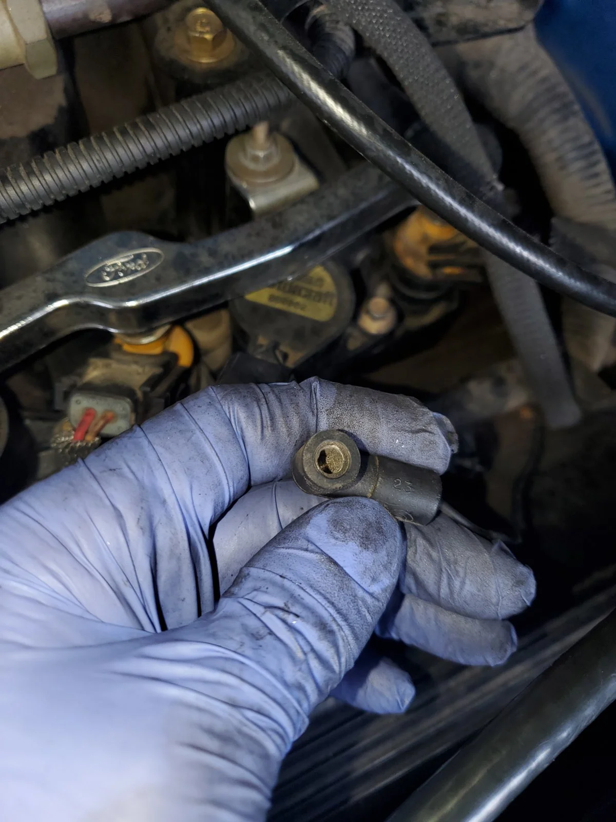

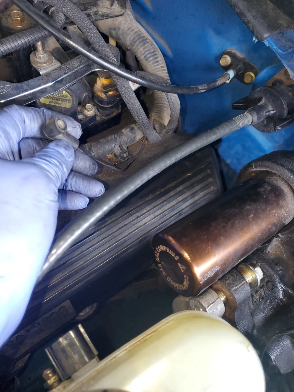

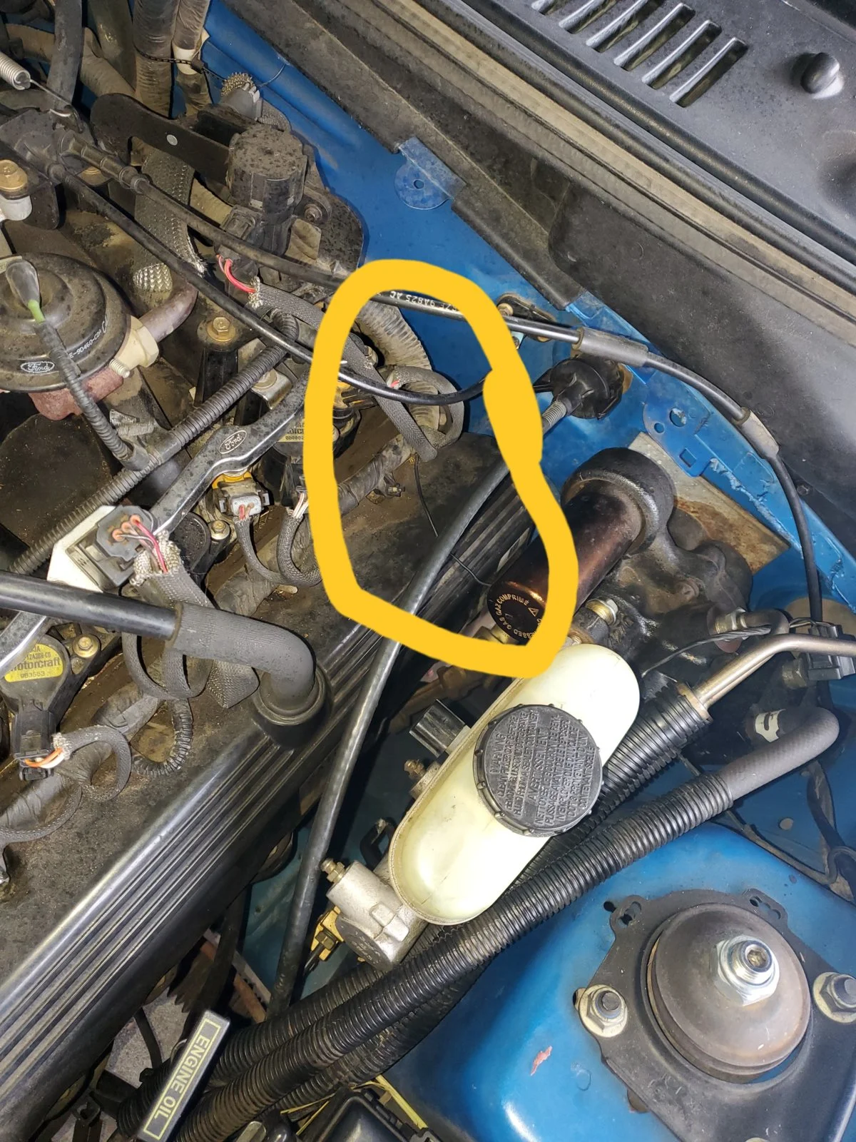

2000 gt I'm working on a brake problem so I'm bench bleeding MC but as I'm taking it off I see this strange line. Its unplugged, incredibly small with a 90 head on it. It's coming out of the harness opening that contains the lines for spark plugs and injectors on the drivers side. What the hell is it lol???

It's a ground wire...it attaches to the stud on the fuel log directly above your index finger in the photo. Verified visually on my 2K GT. Cheers!

Also present on my 98 GT

been quite some time but thx for the info i found the ground you were talking about. just working alot sign the life of a retail manager during the holiday season
