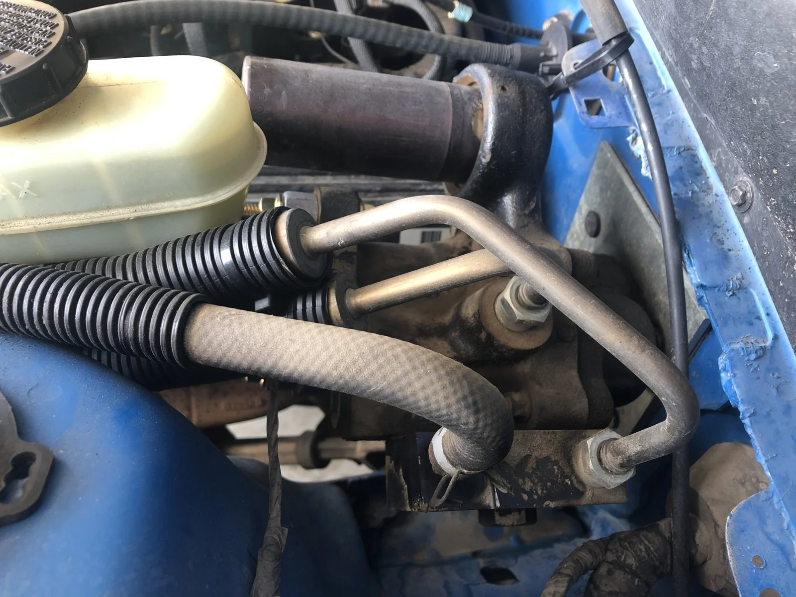

Then I’m super confused because that’s the top of the hydroboost unit. That’s definitely a vacuum line I’ll try to get a better picture once I take it out

ok i bow to the superior knowledge of Mustang5L5
because what I swore was a vacuum line was actually a fluid line. im not sure why it needs 3 lines.. 2 hard and 1 flex hose but what ever lol..... so the brake booster was definitely bad once I got it off the brake pedal hook thats susposed to freely move was very clunky
