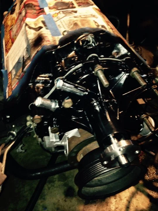

My project is well under way. We pulled the short block and inspected it. Everything looked really good and all was easily in spec. Painted it and back in it is.

Here is the shorty back in.

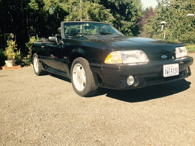

And the car I'm working on. 91 triple black.
