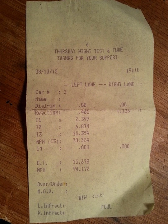

The first run was bad, I spun like crazy in 1st and 2nd, missed 3rd, and ended up with a 15.6 at 94.17

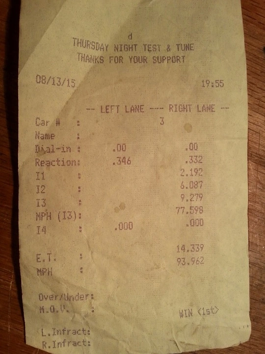

second run was a little better, not as much wheel spin, ran a 14.3 at 93.96
Based on what I've seen my friends cars do, and what I've read, I was expecting closer to 100 mph trap speed. Is that unreasonable?

here are the slips from the 2 runs.
Something is wrong. A stock 5.0 is a mid 14 second car if you can drive it right. your 60 time is terrible. What are you launching at and what is your air pressure
I agree. Stock MAF is a choke point, Get a 70MM MAF off a 94-95 GT . bump the timing to 14-16 at the track. bump up the front tires to 40 and lower the rears to 25-28. reduce all un nneed weight like spare tire, jack, etc. Ice down the intake.
Put some real rear tires on it like Nitto and you'll drop.5
from your ET and MPH if the car weighs around 3400 LB then you are around 220 rwhp. With that trap speed you shoud be around 14.5-14.1
