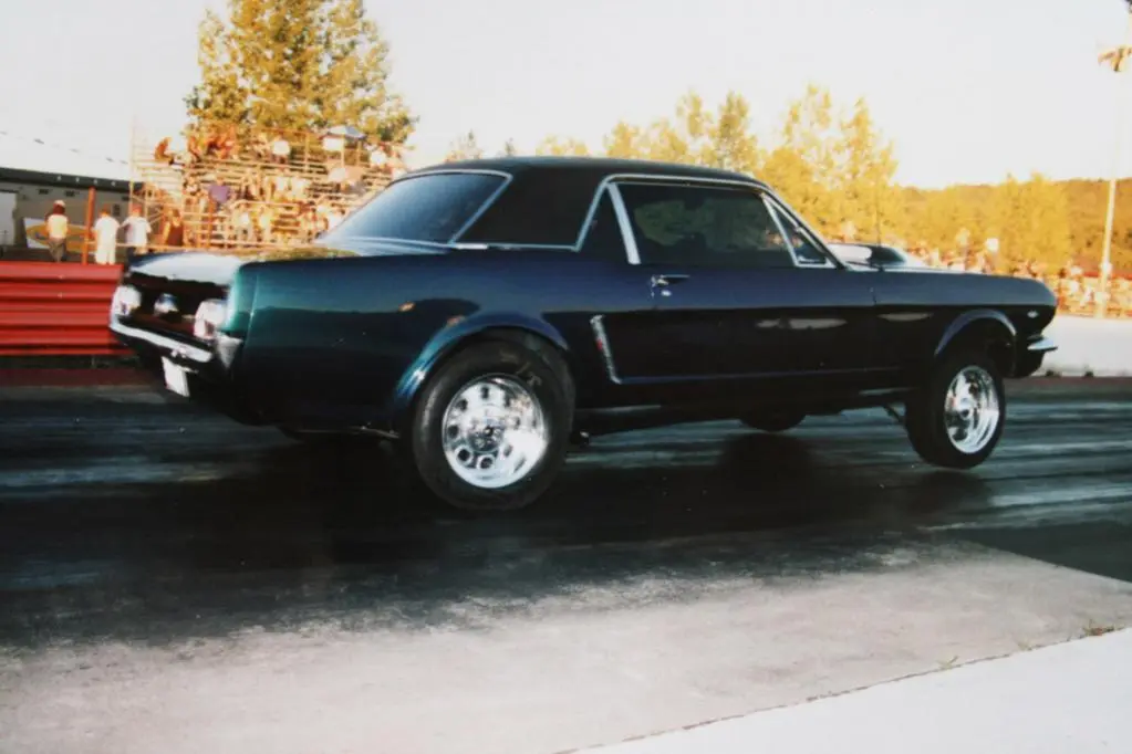

Sorry its a pic of a pic so pretty crappy quality

ya, I thought it was cool, that was the night I was doing 1.65's in the 60. This friday with a better tune and a higher launch rpm it picked up almost a tenth. I'm sure its a little bigger that time. heh
