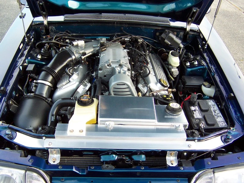

dnbonds said:
Now that's something I may save up for in the military. A coyote swap
or this, 4v cobra terminator swap, I love fox body engine bay, you can pretty much throw in any ing engine you want, and she take it in nicely.

Killa said:
or this, 4v cobra terminator swap, I love fox body engine bay, you can pretty much throw in any ****ing engine you want, and she take it in nicely.
Now that's pretty! There's my eventual engine right there.
