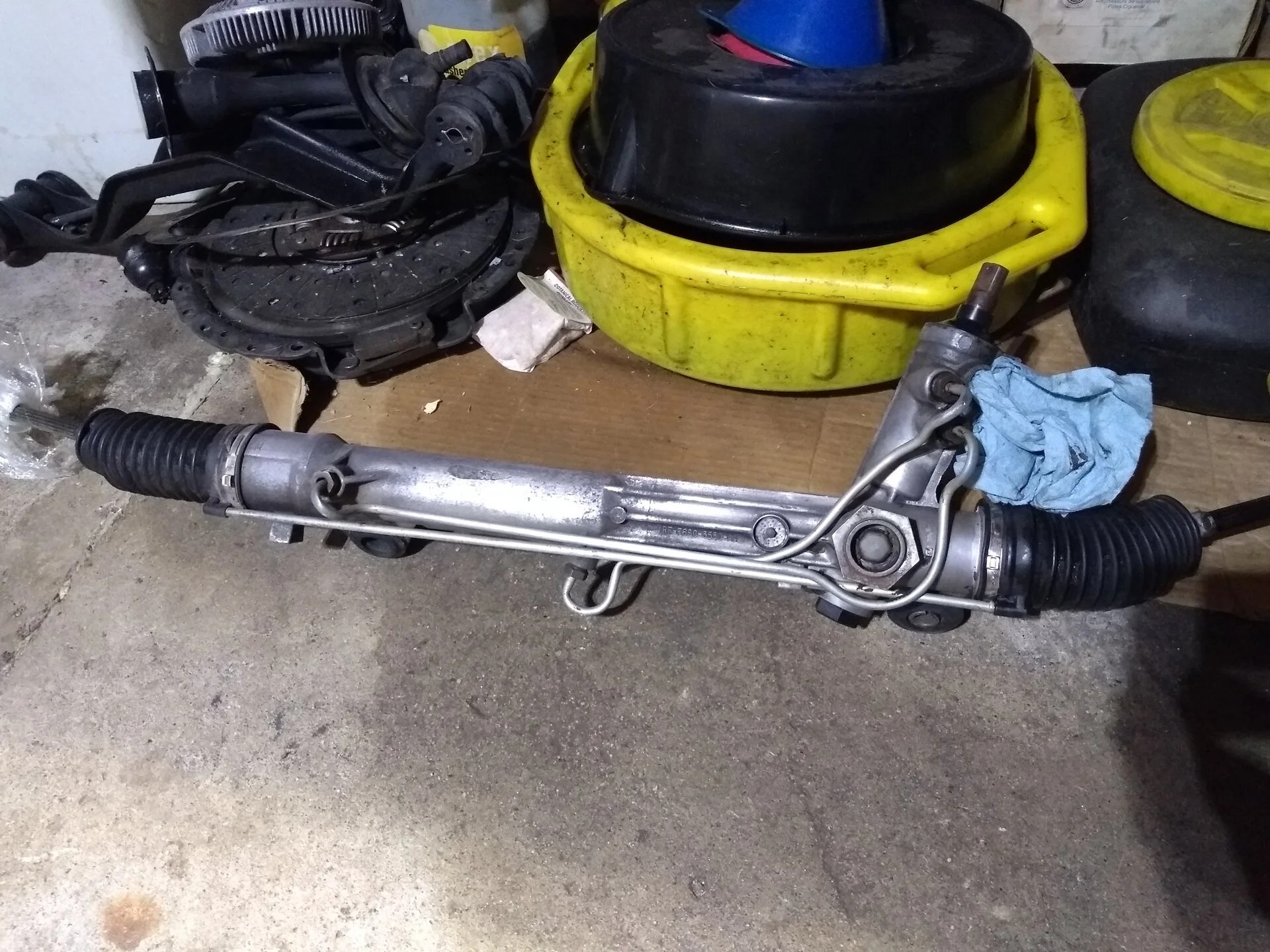

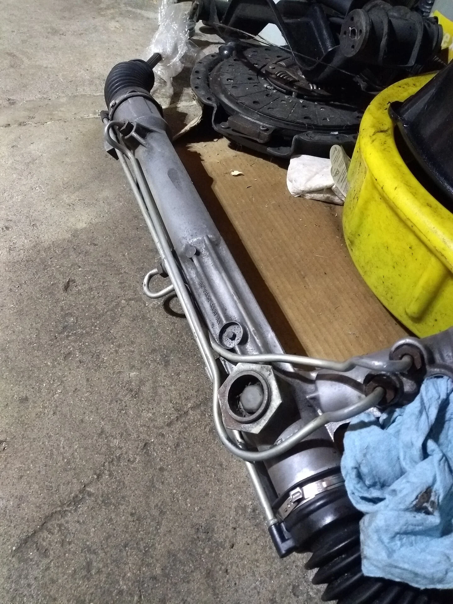

Hello everyone,
I recently purchased a sn95 mustang steering rack. My thoughts are to clean it up, install fox inner and outer tie rods. Also purchase maximum motorsports hybrid steering shaft and aluminum rack bushings.
My question is. Is there a way to test the rack for leaks before installing? Maximum Motorsports recommends if a rack needs a rebuild, have the company TurnOne steering do it. That's 300+ dollars.
I hope this improves the overall feel of the steering. Currently I can turn the steering wheel a lot. Seems like a lot of play before the tires turn. It's currently a reman rack with mm steering shaft.
Thanks.

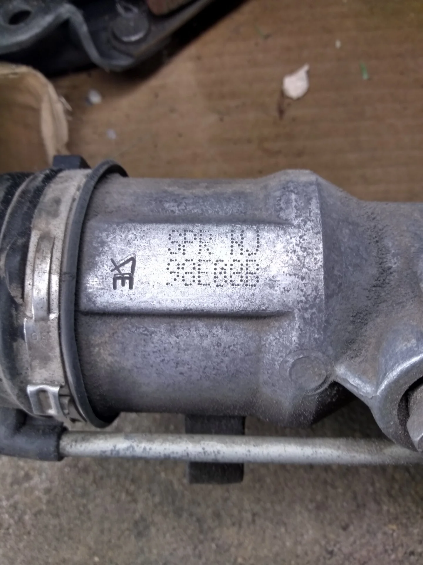

I answered your post on the FB tech group earlier today.
what’s the SPR code on the rack?
If you can carefully grab the input of the rack and turn it, you can feel if it’s loose or tight. The rack should move instantly when the pinion does. Usually if it’s an OE Ford rack that’s never been revuilt, they tend to leak well before the rack starts to wear internally.
once you’ve upgraded to an SN95 rack, it’s pretty cheap to grab another one and swap it in. All 99-04 racks are the same according to a post by Jack Hidley. Means a lot of cheap racks out there to pick up.
I know Turn one will rebuild them, but $300 plus shipping costs is pretty high. You can buy 3-4 used racks for that much.
Reactions: Shakerhood and 91GTstroked

So would you just install it? Wouldn't it need an alignment each time?

yeah, align each time. Missed that little tidbit as I diy my own alignment so I didn’t factor it in

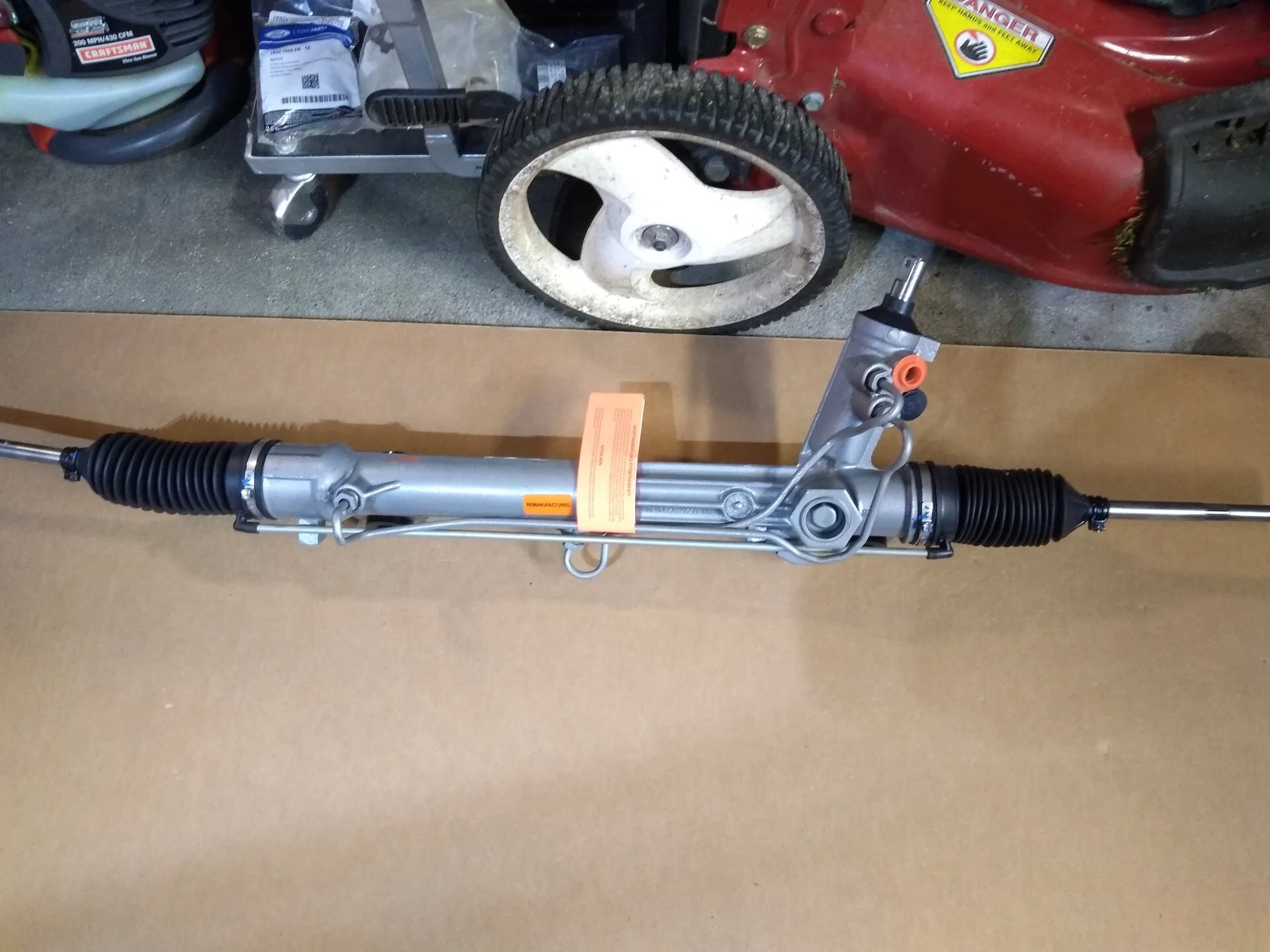

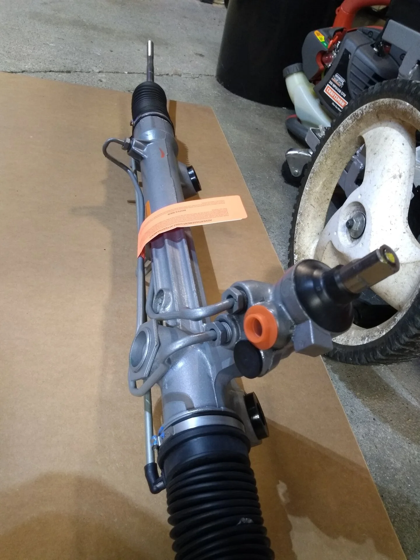

Just picked up my reman from Napa. Hope it works as good as it looks. I like that it's not painted black. Just need to swap out tie rods.
