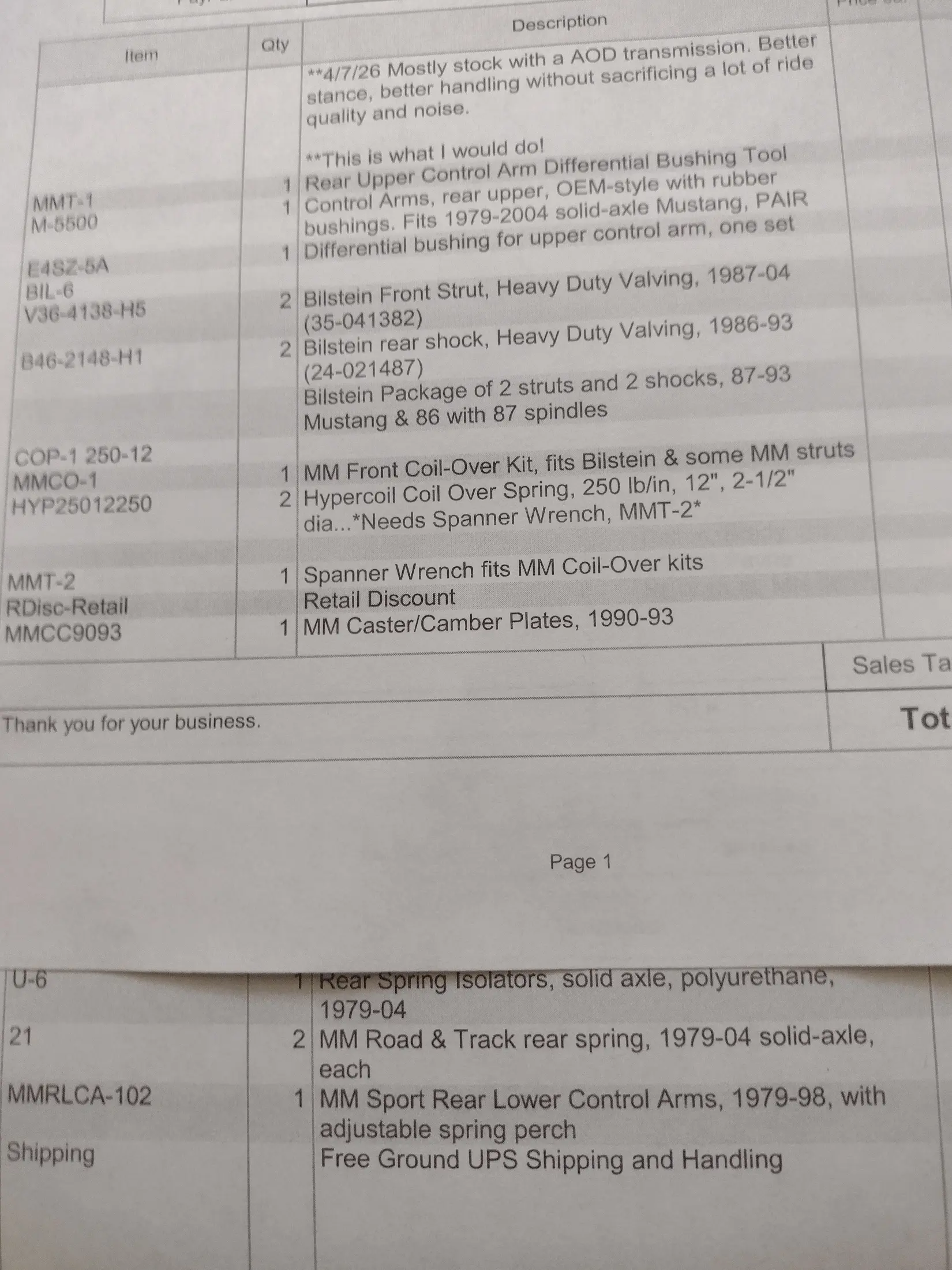

This is what I ordered. MM said a panhandle bar would be icing on the cake. But for now I'm not going that route. Might get a eibach rear anti roll bar yet.
