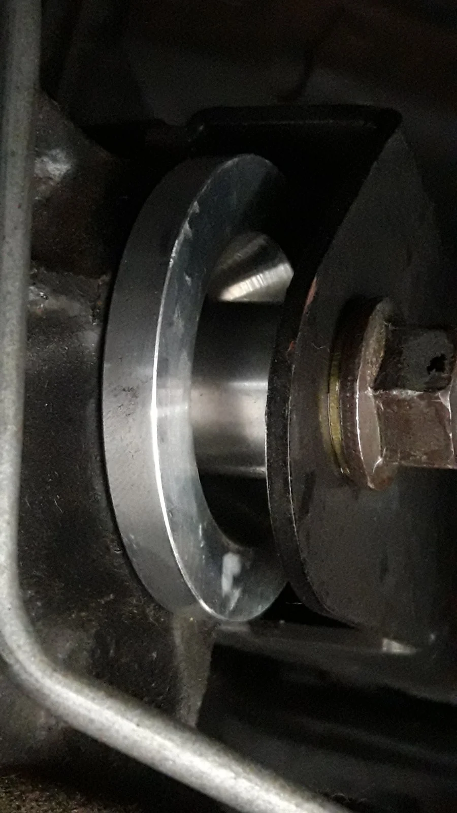

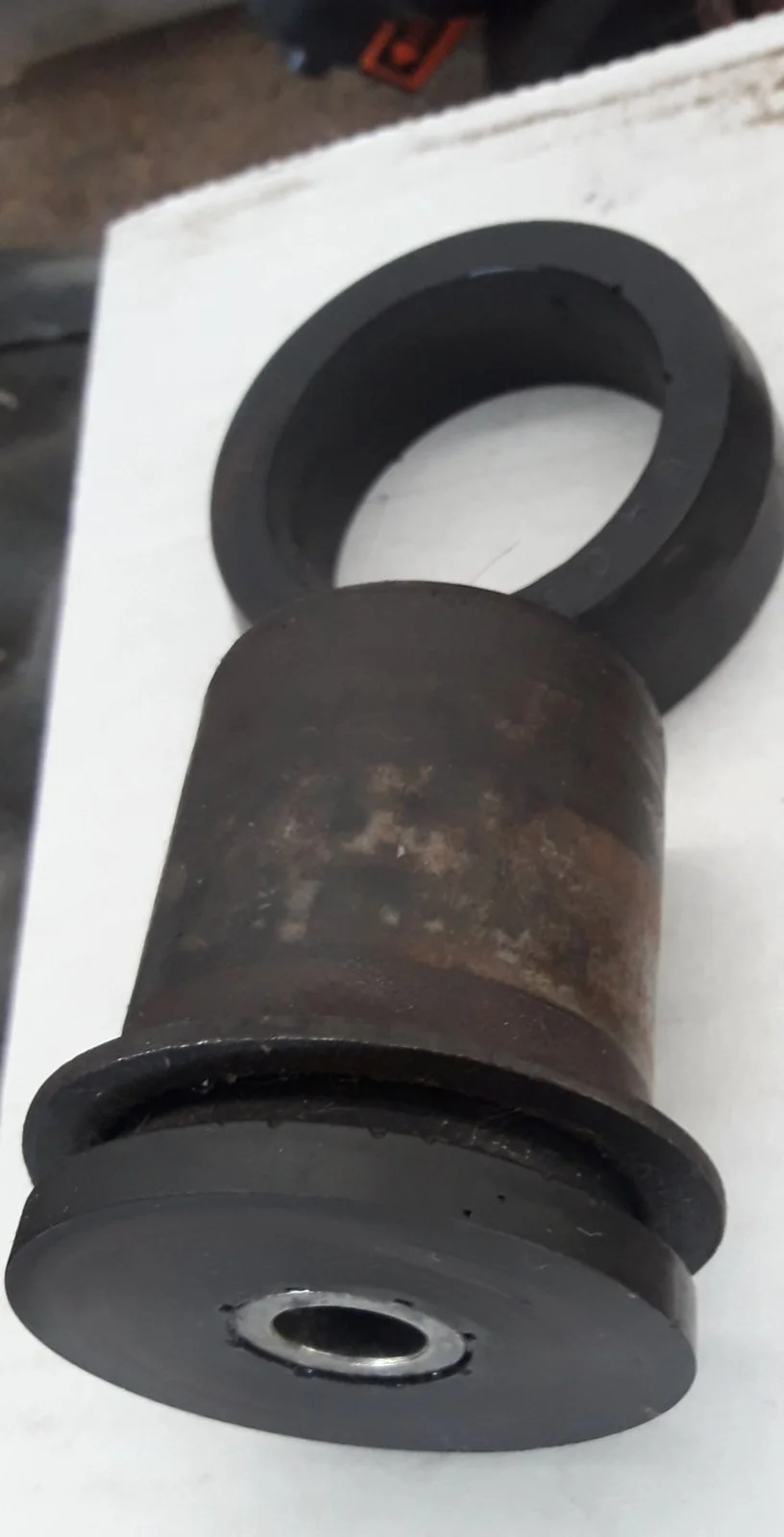

just installed Sphericals from LMR into the upper Axle housing ..was an easy install and they work fine ..no aditional noise, .frame bushing is still poly...but hard to say if this is a upgrade to the Polybushings I was running befor ?? just did it to spend some money and find out..:doh:
Any input on your impression of how it rides would be appreciated.
