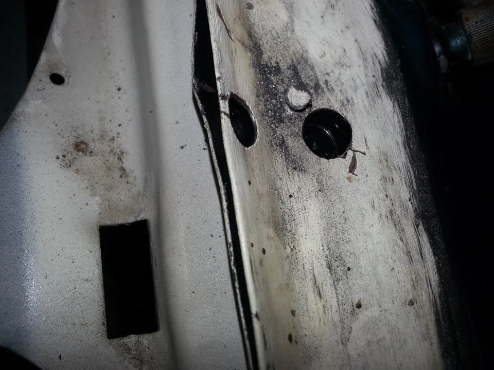

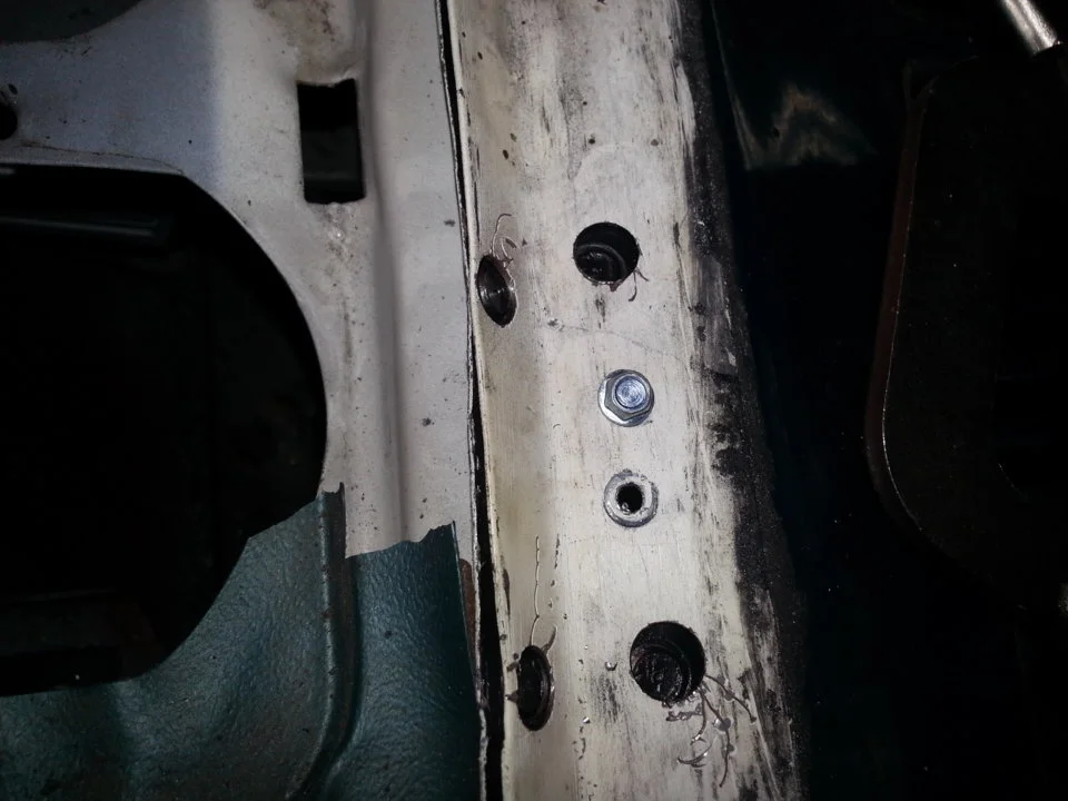

The dash is on the left and the flat part of the upper and lower cowl are on the right which us what I cant line up
horse sence
12,432
8,386
233
Wile Coyote's stunt double
Aug 30, 2015
  • Aug 30, 2015

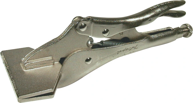

It looks like the lower lip the cowl sets on is bent down away from the cowl .bend it up until the cowl rests on it . what you need to pinch the lip together is a pair or two of clamps with the wide blade type jaws for clamping edges . you can get them at home Depot or any welding supply store.
This first pair is for plug welding the second pair is for clamping an edge .

A pair of the long jaw clamps will help in some areas

I can try bending it up to get that one part screwed together but I cant see any way clams will fit that area as they would have to reach all the way around and under the dash to try and press them together. If I bend it up though I don't think the flange to the dash will fit back correctly.
