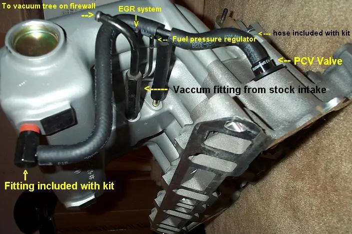

ok does the line that runs from the fpr to the upper intake plug into the upper vacuum line or the lower line? I wouldn't think that it would matter but i thought i'd ask anyways
not sure if it matters which one....but the right way is the FP line goes to the CLOSER (to FPR)vac line. on the cobra intake i have sitting next to me the 2 small lines/tubes on the upper are not upper and lower they are dead level with each other...and that should be the same as on stock.
