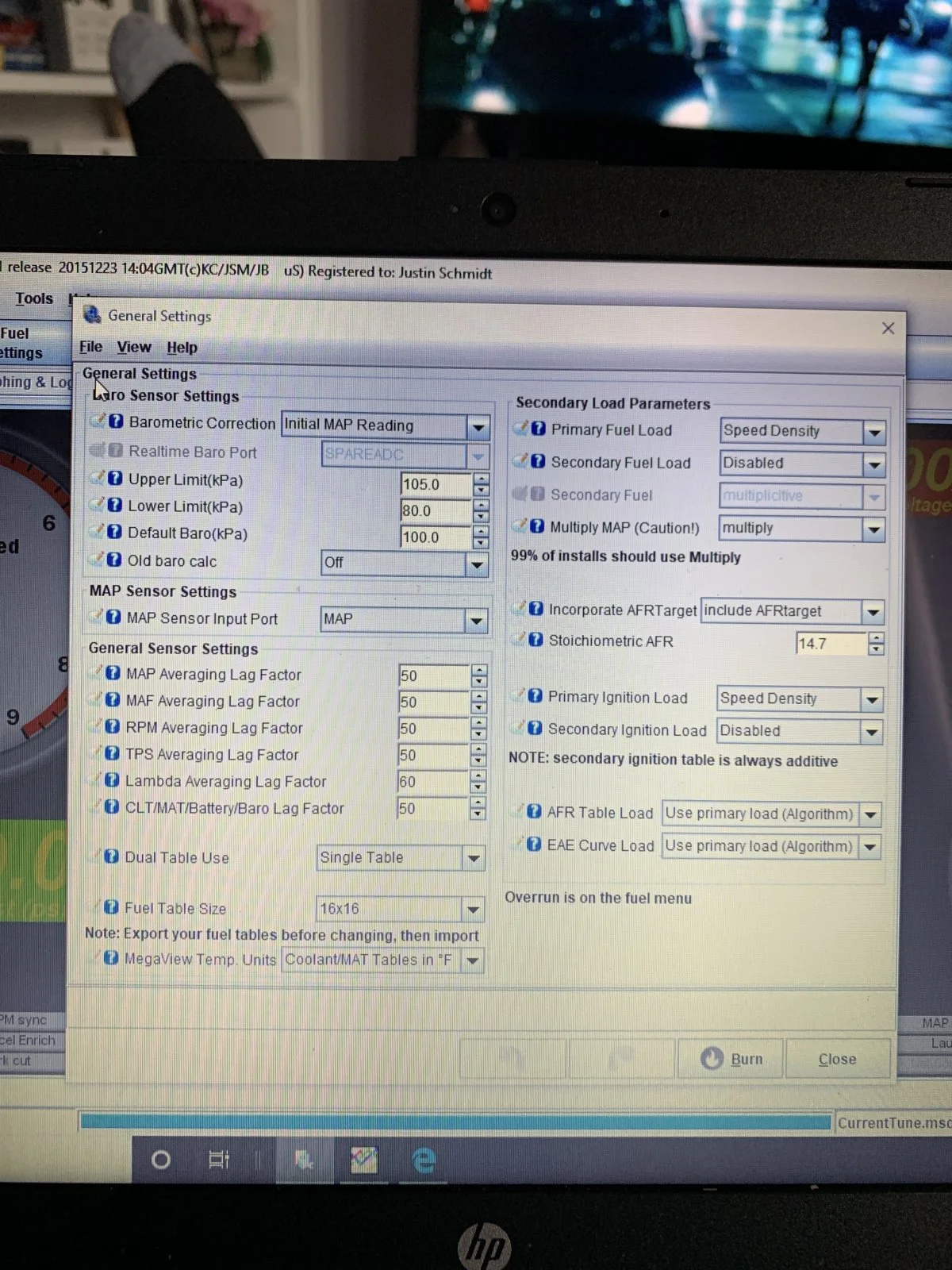

Foxbodyguy49 Member Jul 30, 2019 60 9 18 Longisland May 3, 2020 #1 May 3, 2020 #1 I’m just wondering in general settings if my car is supercharged should I increase my upper KPA limit to match my max boost? Attachments image.webp 262.7 KB · Views: 116
a91what SendMeUrDataLog 10 Year Member Apr 6, 2011 10,739 6,720 214 Hillsborough county May 3, 2020 #2 May 3, 2020 #2 That's for the barometric correction, dont touch that. You just need to scale your ve, afr, ign tables for boost.
