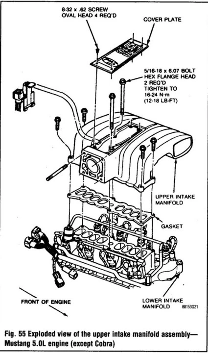

I'm removing my upper manifold to paint it and i was wondering.. there should be 4 im guessing bolts that hold it in before you take off the logo cover. i only can find 3. where is the 4th. if you in front of the car. i found one in front of the manifold on the right and left. then one in the back left corner and when i look in the back right corner i can't find one.?

here you go....

wow i'm always amazed at the detailed pictures you guys find to help people. good work

That is a fantastic picture!
