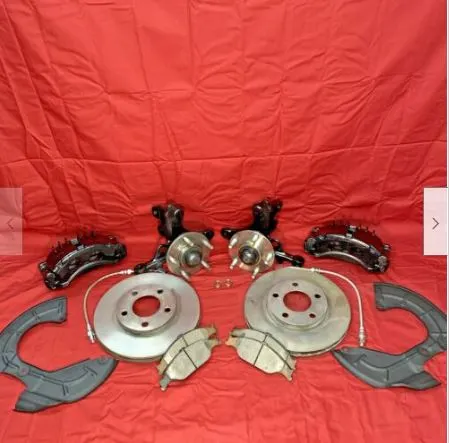

I bought the entire - PBR Front 5 Lug Disc Brake Full Conversion Kit For Ford Fox Mustang GT LX 87-93 and was wondering if some CP21 18x9.5 Gun Metal 5x114.3 et20 will fit?

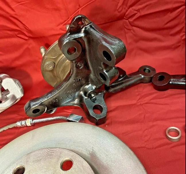

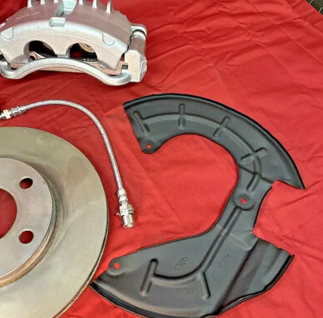

This is the kit - I bought
Premium Front And Rear 5 Lug PBR Brake Conversion Kit For a Fox Mustang! Included Is A set Of 1994-1995 Front Spindles With Brand New Hubs And Brand New Dust Shields modified to fit the Spindles Perfectly As well as Grade 8 Ball joint Spacers For Perfect Fitment, Freshly Turned Front Rotors, Refreshed and Checked Front Twin Piston PBR Brake Calipers In your choice Of Red, Black, And Silver, To Go Along with these Seriously Strong Calipers is A set Of Stainless Steel Braided Brake Hoses That Connect Directly Into your Fox Without the Need Of Any Adapters And Brand New Ceramic Brake Pads
For The Rear Brake Kit Is A set Of Brand New Summit Racing Brand 28 Spline ( Fox Sized Spline Count) Rear Axles That Come out to the Same exact Wing Span Of the OEM Fox Axles, Also Comes With Brand New Rear Rotors, New Rear Ceramic Brake Pads, Refreshed And Painted Rear Calipers In your Choice Of Red Black And Silver, Rear Stainless Steel Brake Lines, Anti-Moan Bracket, Mounting Plate For the Rear Caliper With Dust Shield, And A brand new E-Brake Conversion Kit From LMR Made Specifically For this 5 Lug Disc Conversion. Also Included is a Brand New Wilwood Prop Valve, A bigger Brake Booster and Master Cylinder

Those look like 96-04 spindles (just so you are aware).
Freshly turned rotors ? ... Are they used rotors and calipers? New ones should not need to be turned. Just so you know, I have no issues with used, in fact my complete system is used.
Dust shields shouldn't need to be modified to fit spindles either.
Sounds like a pretty complete kit though.

I'll be buying new rotors. But yes all used calipers and rotors and spindles. But he did provided a bigger brake booster and brake fluid reservoir from a Cobra.
Turned rotors are fine, just hope you didn't pay new part prices.
I used rotors as pulled from the wreckers. Just make sure there are no grooves or raised edges and you are good.
