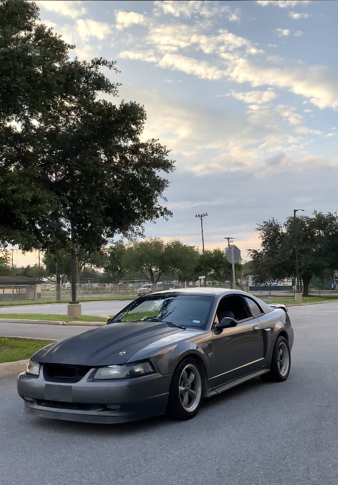

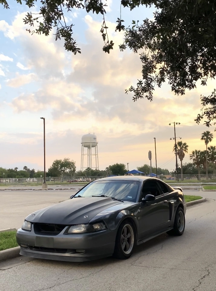

Hello my fellow mustang brothas I never updated yall but after these messages it took me a whole month turbs out the knocking was the new rod bearings my crank and rod bearings were :poo: even tho they were brand new!! It messed up my crank as well shaved it down pretty good had to buy another set of bearings including the crank after about a full week of of screaming, kicking , loosing bolts and 10mm and nonstop working she is finally on the street running healthy as can be and screaming i appreciate all the help I got from every single one of y’all
