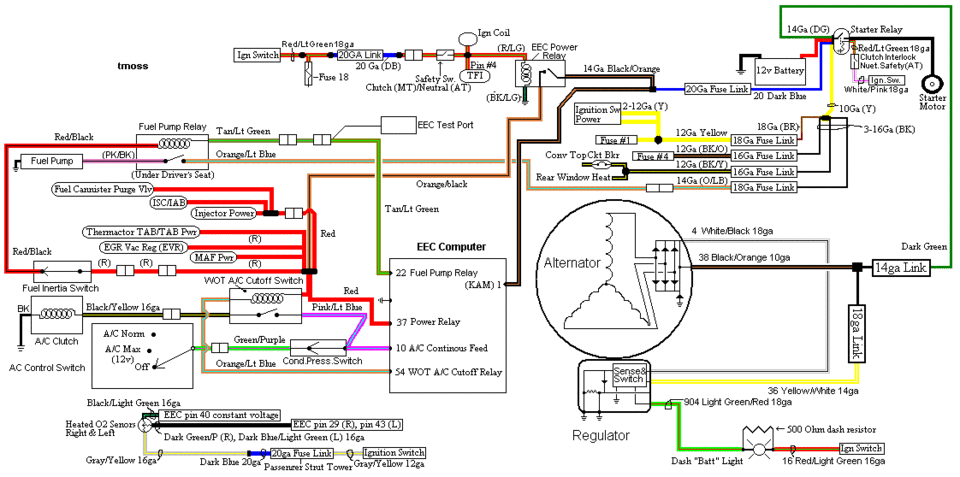

Just figured I'd update this for future people. It was the fuel pump! It didn't have a one way valve on it and the wiring to it was from the acc. panel (jackass who owned it before me) so it would lose all fuel pressure while trying to start. I just wired up the relay to run it while cranking so now it's golden. I'm gonna take that stupid pump out of there before I sell her though. I'm actually having more trouble after I just put a head gasket in. I'm getting no power to the injectors. The ECU relay is clicking. I don't get it.
Go back the the Cranks OK but no start checklist. You will find the problem.
For the fuel pump wiring:
See the following website for some help from Tmoss (diagram designer) & Stang&2Birds (website host) for help on 88-95 wiring http://www.veryuseful.com/mustang/tech/engine/
http://www.veryuseful.com/mustang/tech/engine/images/88-91eecPinout.gif
