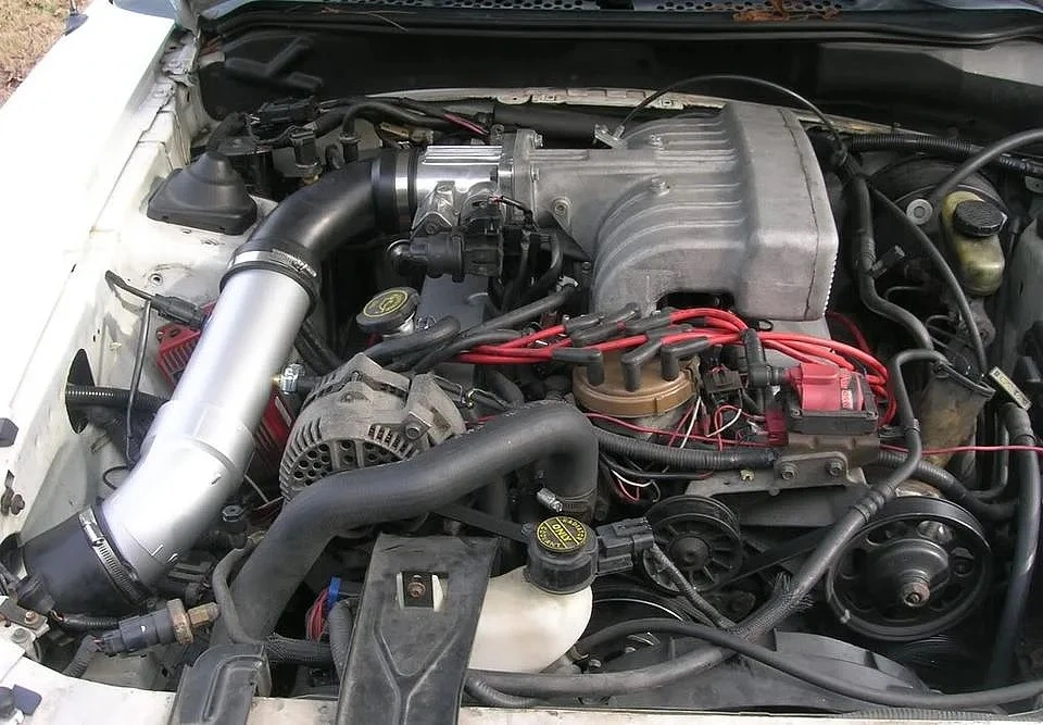

I want to work on cooling the air for my V1 . I've seen some pictures of air being pulled from the fender but closer to the wheel well (there's a plug there now). I want to put a front mount on it next and I figure the spot where most cold air intakes draw from can be opened up a bit to run my intercooler piping. If I could find a kit that would allow me to think/work less, that would be awesome. Any one got leads?

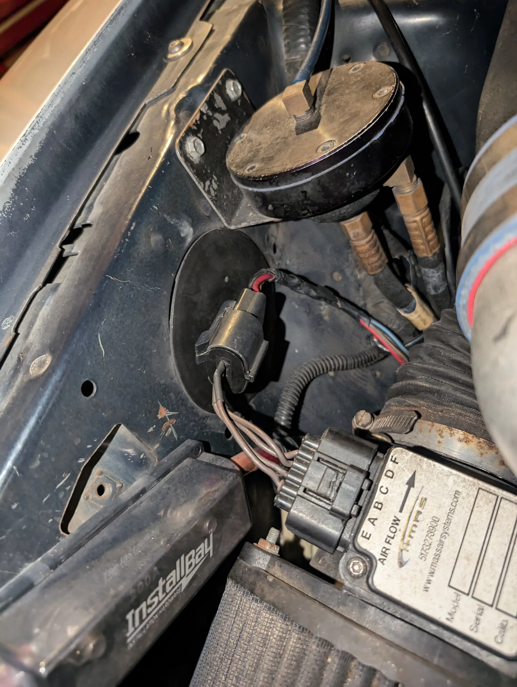

this is where I want to have the pipe go through. Anderson makes a box of plate and shows a pipe going through this hole but not a lot...looking at it I think a couple 90s and straights would do the job. But I'm not a competent welder by any means
It’s pretty straight forward. You’ll need to enlarge the hole in the fender. I used a body saw for this. It’s also a good idea to use some type of edge protector. You may also need to lengthen the maf wiring.
