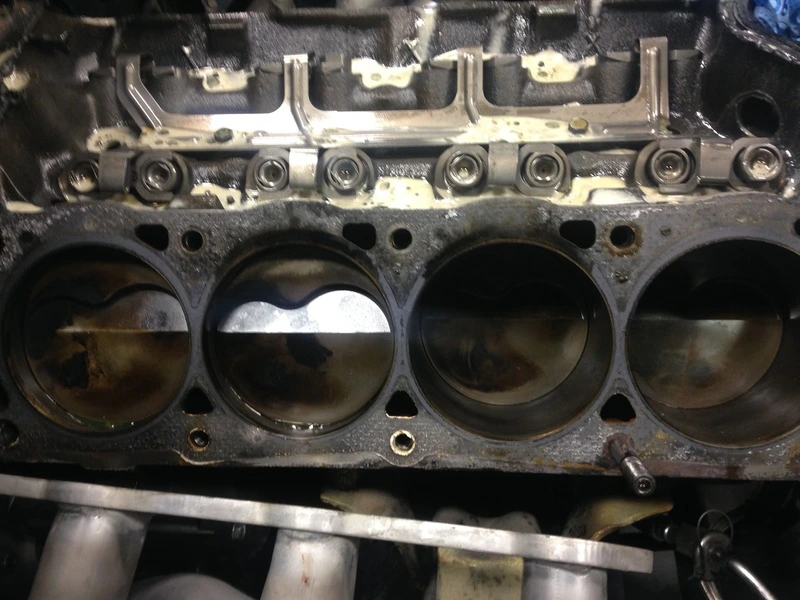

Ok...i tore it appart AGAIN!....started with the same side that blew before and sure enough!?

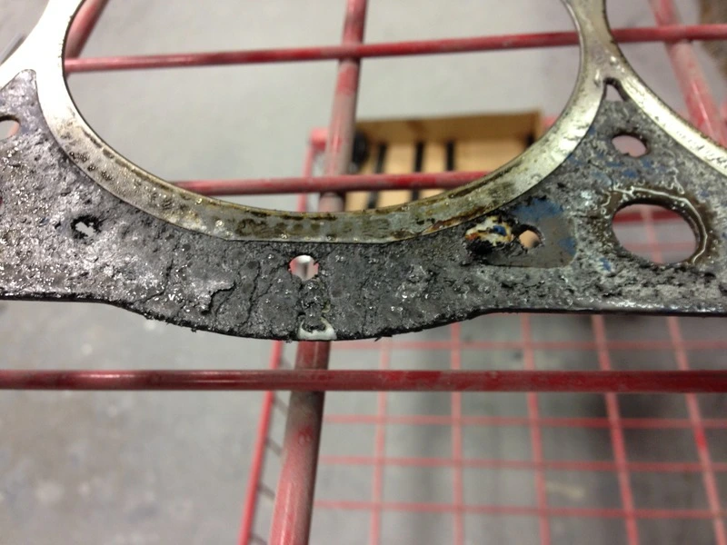

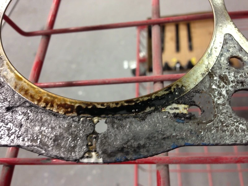

This time looks like it blew at 2 spots,the other side seems fine...

This is the same side same cylinders right? If so you may have a serious problem.

You may want to have the heads and block checked. Just as a precaution....

Check the heads first. Don't freak out, I'm no expert. just going off of what I've read, if it has failed twice in the same spot..... I would assume warpage. but assumptions usually come back to throw egg in my face.

w
smkshw said:
Thanks for the support guys....lol
well the fire ring held.... but.... that don't look pretty. Lay a straight edge on that deck and see if you can stuff a thousands feeler gauge in there.

As thermally stable as iron is, the stock 302 block is pretty thin, and most newer aftermarket heads are pretty thick. Would not surprise me at all if the block went before the heads, you're at the level now anyway where the valley is a ticking grand canyon.
