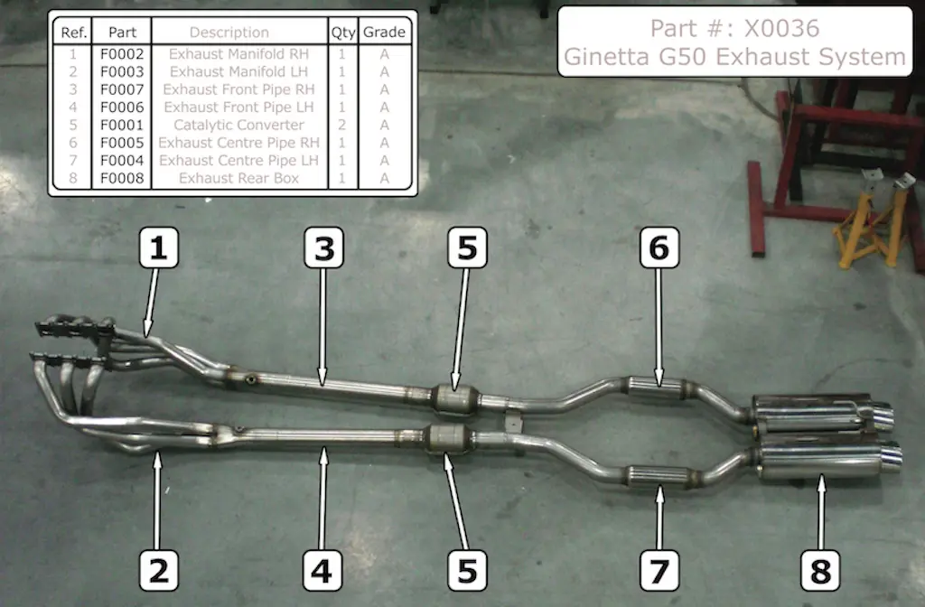

So I wanted to start a topic to discuss designing an custom exhaust system. I have a 3.7L in a 1966 Mustang. I just got done building a set of equal-length long tube headers for it....but wanted to start thinking about the rest of the exhaust system. From what I have read since v6s are inherently balanced(unlike v8s) they gain no actual performance benefit from a H-pipe or X-pipe(though it does alter sound). Presumably it is actually better to run true duals on a v6...with a separate system for each bank of cylinders since it avoids the turbulence of a crossover pipe of whatever type. I was wondering if anyone had more insight on this idea. It would certainly be simpler to have true duals(and slightly lighter). My goal here is to build a system that squeezes every last HP out of the exaust...the plan is true duals into a glasspack on either side with a resonator after each pack to hopefully tune out some of the resulting drone. The headers themselves are 35" primaries of 1 5/8" diameter reduced down to 2" at the merge collector before returning to 2.25" after the trumpet portion of the collector, and 2.25" piping all the way back.

For reference: The exhaust system from a Ginetta G50(which also uses a Ford 3.7L making 315-355HP depending on trim)

As you can see...no crossover pipe(and I personally like the sound, though sound is very much subjective).
Also interesting to note on this exhaust system is that after the merge collector necks down it doesn't flare back out again like most...it looks like it necks down to 2.25" and stays there the entire time(probably to maintain velocity). I do wonder why the cats are so far downstream though...obviously catalyst light-off time isn't of any concern to them...I am wondering if there is an advantage to placing them that far away from the collector or if its just where they had roon on the chassis
