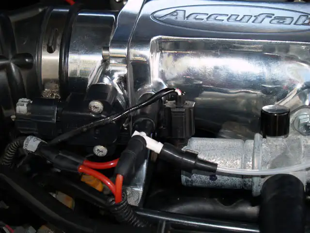

I used this same location
sneaky98gt
Apr 23, 2008
2,387
144
114
NC State University
Nov 17, 2010
  • Nov 17, 2010
Ha, I had the same problem. Here is my own answer to the same problem you have (not making boost):
sneaky98gt said:
Nevermind, got it fixed. Turned out that I had the boost/vac gauge hose in the wrong spot. I originally had it on the nipple used for vacuum diagnostics.(This is where you have it hooked up) The vacuum part of the gauge worked fine there, but apparently the boost part doesn't. So I moved it over to a hose coming directly off the top of the supercharger, and voila.(I don't know if you have somewhere like this also, but I would try splicing it into some other part of the vacuum harness) Everything works perfectly now.
It's actually making upwards of 8 pounds of boost, which makes me happy. More power for me.
Hope this helps.

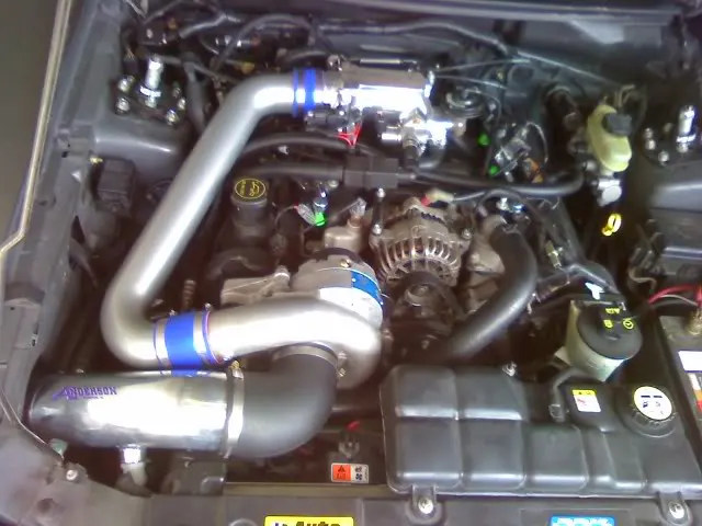

This is my engine bay

I think the spot you had it is ok, according to several threads I have read. Why are you trying to get boost in neutral? The engine has to be under load to really build boost. Especially centri and turbos.
Like sneaky said, What is you boost under LOAD, it the gauge reads zero than its mostly likely wrong. As you drive down the road what does the gauge do? How did you tap into the vacuum lines in the area?
Looks like you simply pulled on of the red lines out of the rubber connector, right? Could there be a leak it you tore the rubber? Check and maybe zip tie the lines on there.

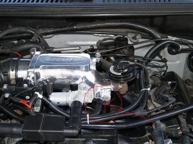

So i called the shop that works on my car and they tell me to tee the line at the fuel pressure sender on the fuel rail. Where exactly is this line?
I'm a noob, but I'm going to guess right here.
