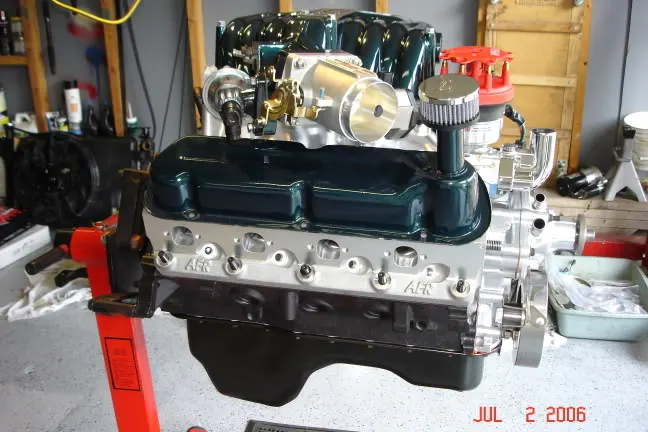

I just stripped and painted the factory VC's. AFR heads and 1:7rr, no clearance issues at all.
