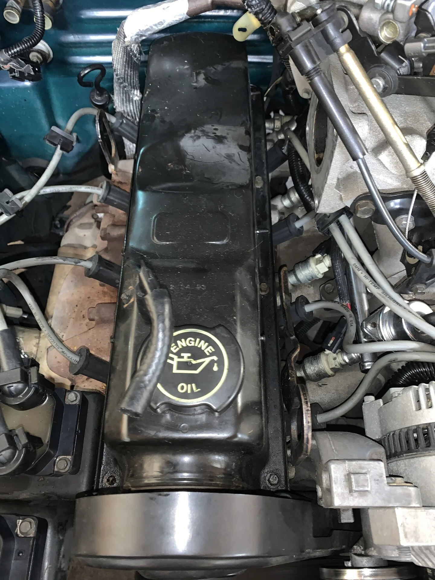

glowstang93 20+ Year Stangneter Feb 9, 2003 853 8 39 Illinois Apr 18, 2021 #5 Apr 18, 2021 #5 All set to remove cover. Going to wait for one of my sons to help line it all up. Hoping that EGR tube is going to be out of the way enough to position cover back in Attachments 17461BCD-2021-4952-B303-8231A396FB84.webp 359.1 KB · Views: 173
J junkyardwarrior Well-Known Member Jan 10, 2011 400 113 63 May 13, 2021 #6 May 13, 2021 #6 hope you got the correct gasket. Motorcraft, F57Z-6584-A it's the only one worth anything.
glowstang93 20+ Year Stangneter Feb 9, 2003 853 8 39 Illinois May 14, 2021 #7 May 14, 2021 #7 I went with felpro blue rubber gasket. Hasn’t been on long but not leaking now. Reactions: 7991LXnSHO and General karthief
