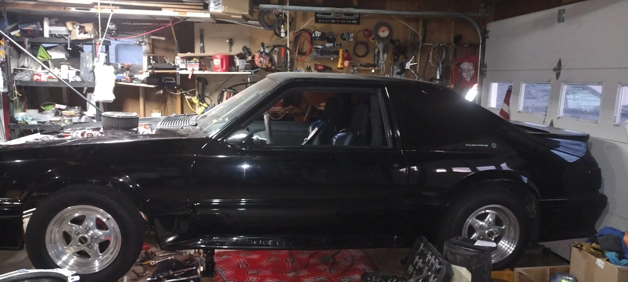

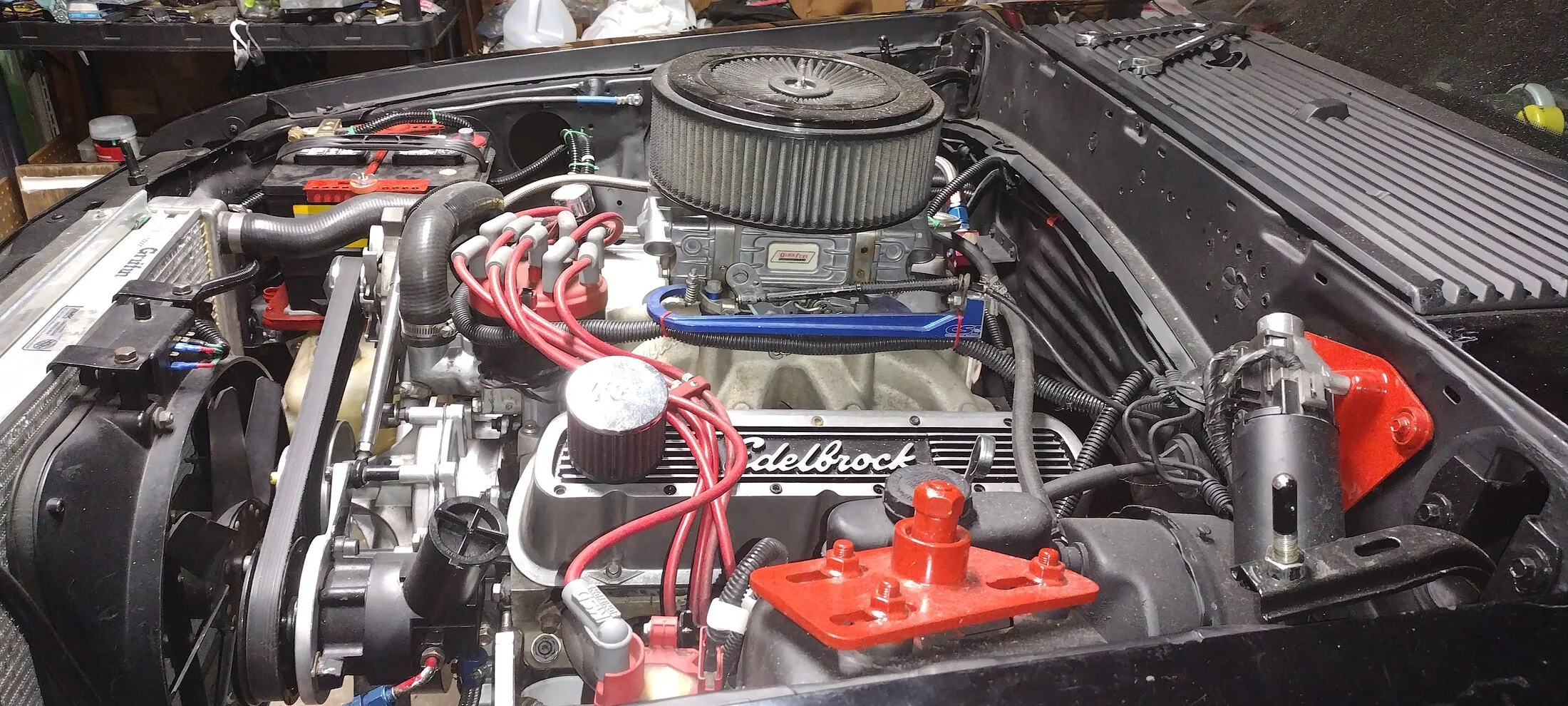

I have a 1987 Ford mustang GT Foxbody 302 block made into a 347 stroker and a T5 transmission. I hade to change the rear main seal due to a leak and ever sense I replaced the rear main I have had a very violent shake in my shifter handle at higher RPMs I have had tires balanced drive shaft balanced new crossmember mounts new tranny Mount new motor mounts new throw out bearing but still it vibrates at high RPMs anybody know why thank you for your time and help

Sounds like an engine balance issue. Remove trans and double check everything. Did you change the flywheel or clutch while it was apart?
Yeah that's what I thought too but it's a balanced motor to harmonic balancer and flywheel are balanced and no I didn't change anything but the rear main seal everything else was good as far as the clutch and flywheel
Sounds like you tried everything so far, but you can remove the trans again, take the clutch,pressure plate off and see if it helps.
If not then remove and check the flywheel , maybe swap it out.,since that's when it started.
You can also check the balancer,see if outer ring moved. Just a couple of things it might still be.
