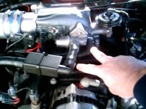

Did you swith the vaccum hoses. I did , I put the hose from the the intake pipe into the plenaum. I just wasnt paying attention. Check the pic out.

the only piece of hose i had to replace was the 2 1/2 hose from the metal pipe to the pcv valve. since tomorrow is going to be somewhat nice i believe we're throwin the intake gaskets on it, ill also check the rest of the hoses etc.
