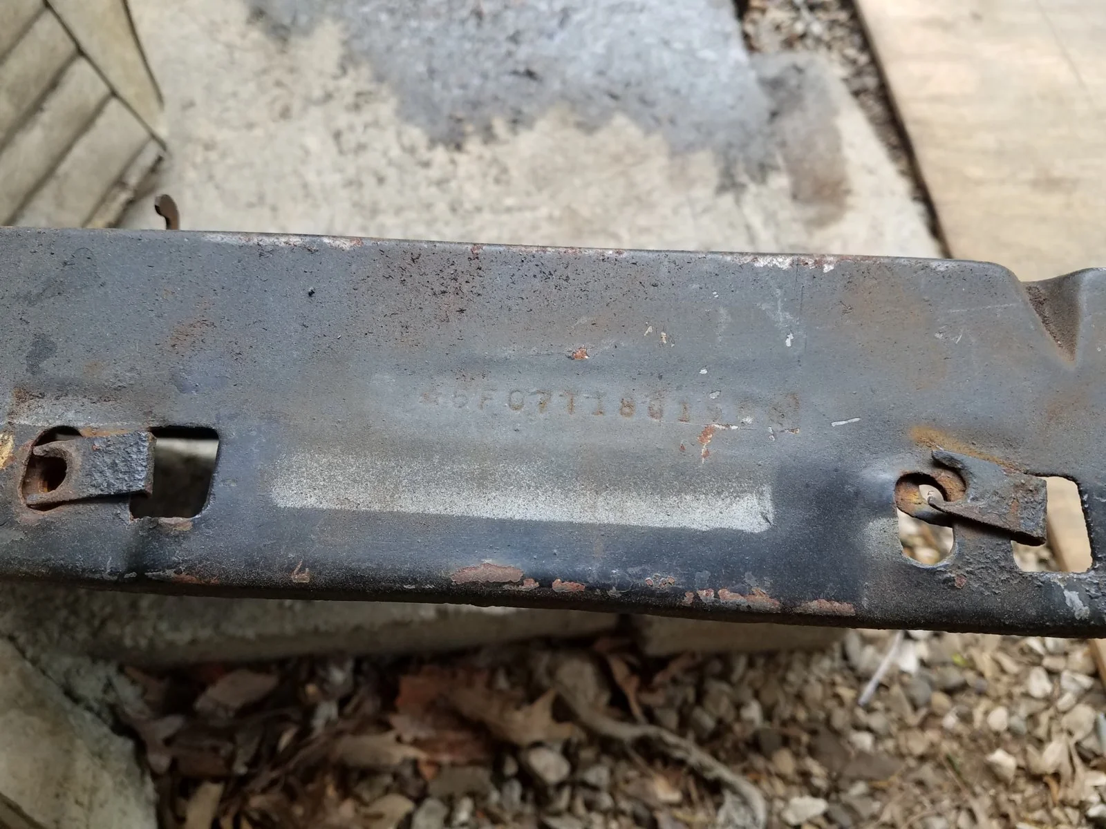

A year ago I purchased a '65 Stang Coupe with 289. There is the 11 digit warranty number on driver's side fender under the hood, AND, that is used as VIN number on Alabama registration. There is no VIN # in any of traditional places. Alabama Does not title vintage cars so registration is all I have. Can Ford (or anyone) provide a VIN # from the warranty number?

I thought that was the VIN. Are you talking about the numbers and letters stamped into the metal on the inner finder?

[Yes Sir I am. Apparently, that is the warranty registration number with 11 digits. The VIN has 12 digits. QUOTE="Olivethefet, post: 9234073, member: 221146"]
[/QUOTE]
Feb 25, 2019
18
70
Lake Martin, Alabama
[/QUOTE]
None of the numbers in this 11 digit stream match any of the VIN explanation codes that the 12 digit VIN refer too.

This is where it "should" be stamped...the front fender apron. It is also on the door plate assuming you have that(I know you said its not in any of the conventional places). Is it possible you just cant see it?(might have to take a wire wheel to reveal...or do the charcoal rubbing thing. Was the front fender apron replaced? Hard to track down a VIN number....but I suppose its possible the DMV keeps records of that type. Any clue as to whether this was an original AL car? You can trace previous owners and maybe get help from them about cars registered to them until you can find something with the VIN.

On mine, just an example....this particular one was transferred from the original apron when the car got in a wreck...and then I replaced the apron a 2nd time(because it was installed badly and already rusting again) and have yet to transfer it again to the new apron...mine is 66 though...just for the record, my VIN is 11 digits.

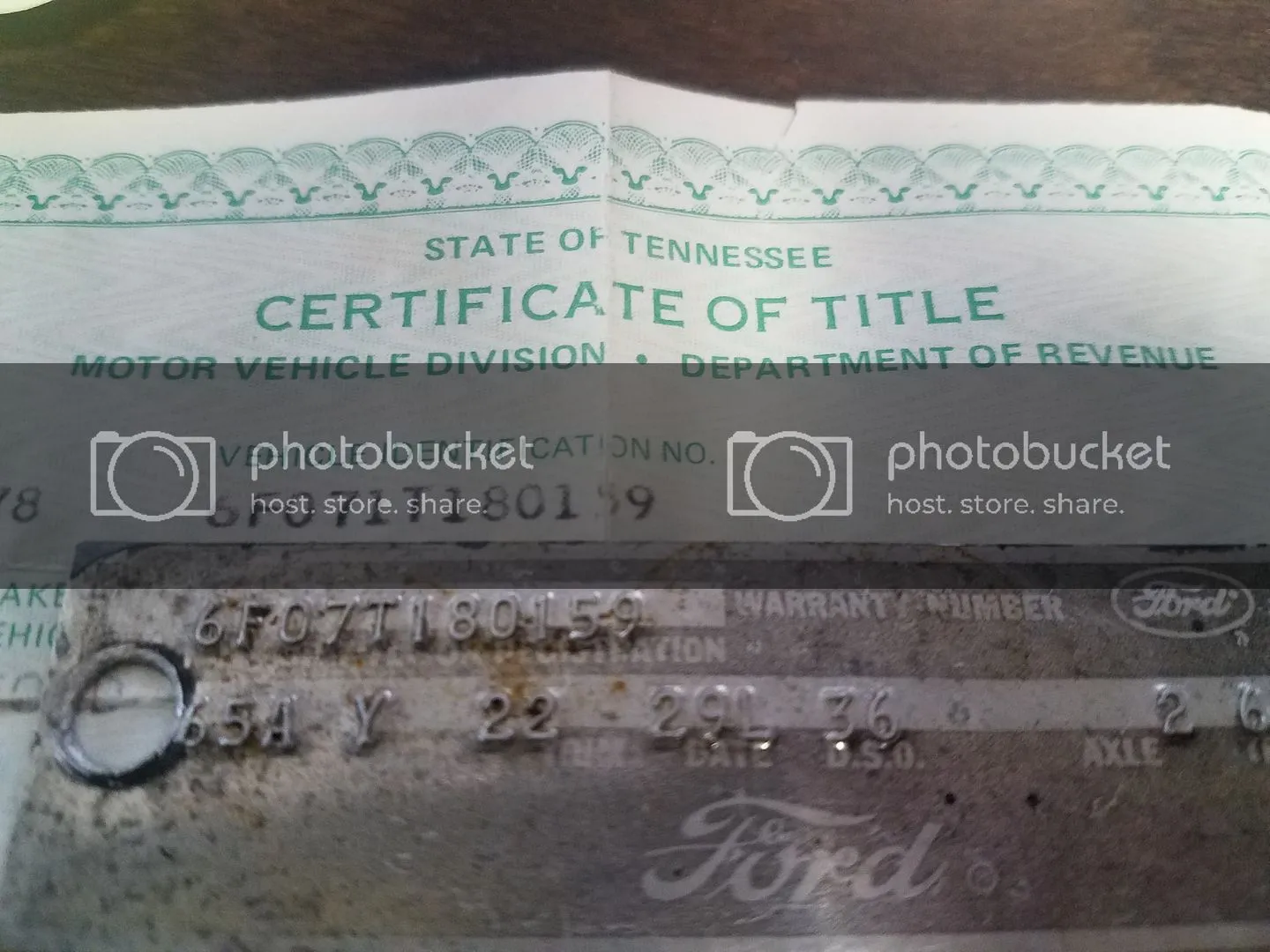

This might help clear up the confusion. This is my door tag(not the OPs) and title(car is not yet registered). Notice the Vin on the title has an extra 1 after the 7 that the door tag does not have. For what it is worth...this title is dated 1977, other people can check their titles and maybe see if that digit is also a 1 or if it varies? Either way...it narrows down the vin to 10 possible numbers

Called Ford using wicked93gs posted number for the warranty tag, knowing the VIN that is noted on his title and they gave me the following:
The 6 digit number found on the inner left fender goes behind the engine code to create the proper VIN for the 65.
He seemed to be confident about this information. It does not follow what wicked93gs VIN reads but TENN is kind of a oddball state.

Sincere appreciation for all the information. But it looks like none of the solution s give me a VIN that matches up with the "decoder" plan to show me the original color, body style, engine, etc. On well, just though I'd see if anyone else had similar problems, looks like a lot of us are in the same boat!! Thanks again!
Engine is easy....you only have a few options T, C, A, or K code, and that is specified right in the VIN or warranty number, 200CI 1V for all T-codes, C-codes and A codes will be 289ci .....2v or 4v for the C codes depending. I believe all A codes were 4v, as were all K codes(K codes in particular should have been the only ones with the HiPo engine). Original paint color is listed on the door tag...in my case it is Y...which is silver blue. trim 22 which states blue w/ blue trim interior(though stripped down it sure looks aqua or torquise to me, and the seats that came out were parchment...guess someone repainted it at some point and swapped in parchment seats) DSO code on mine is 36...which is Louisville(guess thats where it was shipped?) Axle 2(2.83 non-locking) and trans 6(c4-automatic). 65A means it was either a coupe or fastback(not specified...but of course its a coupe)
Door tag decoder:
In the end though, the ONLY coupes that are worth enough money to be particular about the details are A codes(GTs) or K codes(HiPo engine)....they did after all make a million of the things...literally, which is why its very rare to ever see a coupe sell for more than 20k
