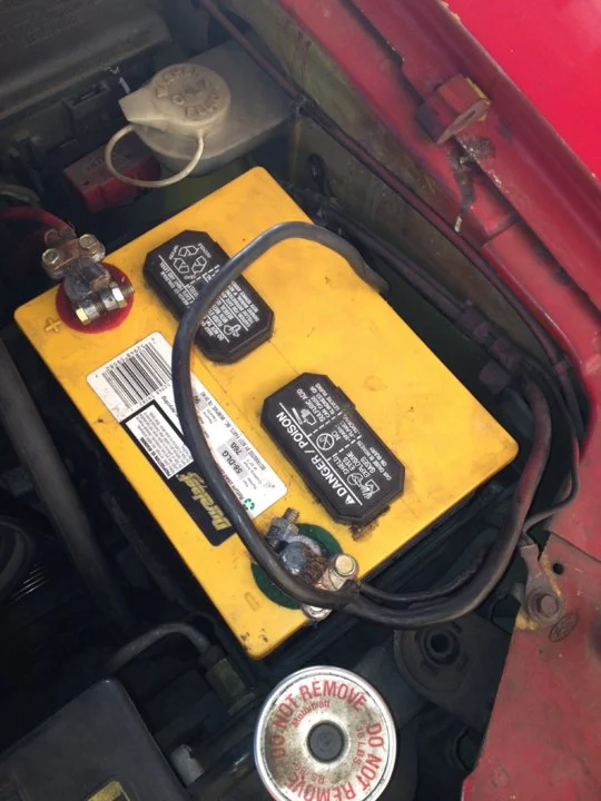

There is a cable that it connected to the battery which is ground I suppose since it's black, It's just dangling around. I'll take a picture right now and post it up.
Which grounds should I clean? and where can I find them exactly?
Thank you!
Here are the pictures, It was just hanging so I stuck it in a little hole which I think it came from.
Not sure where it goes.
(It goes to the black bolt on the right side next to the Washer only Fluid)

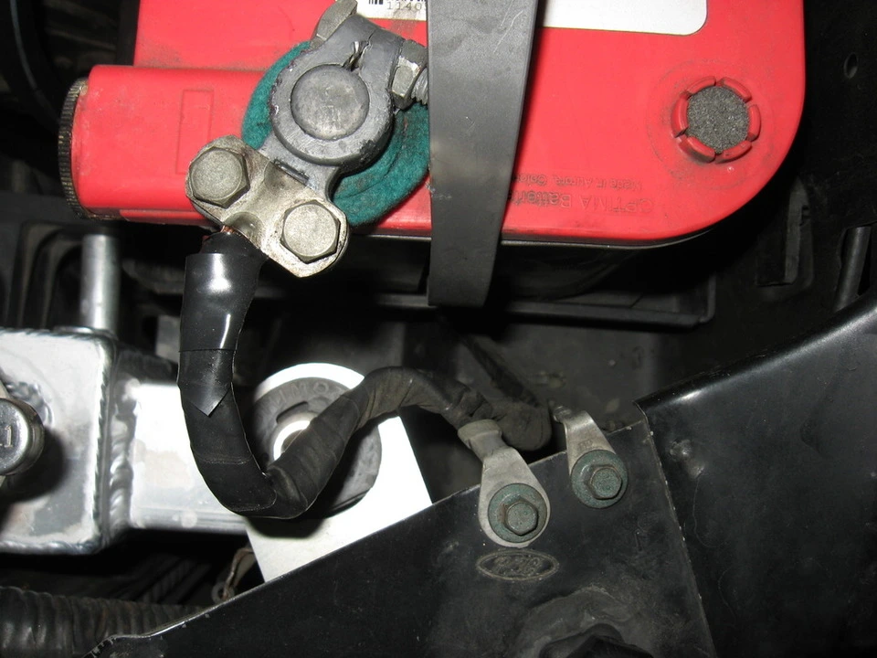

I believe you have an extra wire that probably shouldn't be there. I only have two wires coming from the negative terminal; one goes to the grommet to the right side of your pic, and the other leads...somewhere. I did some wire hiding so it's harder to trace wires now. Here's my negative terminal:
Ahhh yes! On my picture you can see one extra hole which is where that extra wire goes connected. I will do it tomorrow. You fixed my problem!!
From the battery should be a 2 ga or larger cable to the engine and probably a 10 ga to the chassis where shown in the photo. You also need at least a 2 ga from the engine to the chassis to ensure that all other grounds have a good return path.
