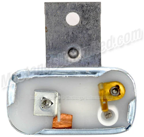

Here is a pic of the CVR.
THe CVR will affect the gauges. It sounds like when the alt gets up to speed and starts pushing a charge to the battery-meaning the current flow increases to something more than a small trickle ( at idle) that a gound connection is breaking down somewhere. WHat is the voltage output from the alt above 1k rpm? SHould be around 14v or so. Curious to know if that measurement is a lot higher than 15v...
THere is a ground wire that should be attached behind the inst cluster, if that is off, it might cause a problem. If the gauges work then it's probably attached...
